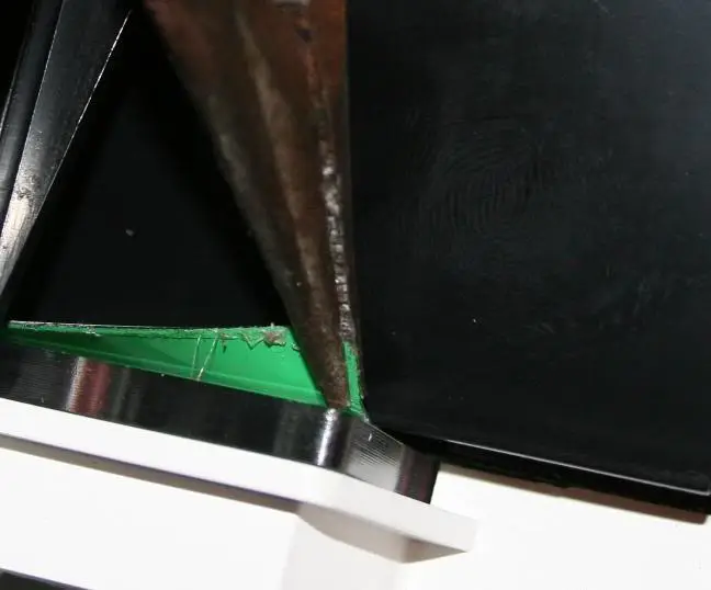

Would anyone happen to know any details on how to take off the face of the HVAC? I was stuck because the little tabs around the outside wouldn't push in and I wasn't able to pull off my middle knob. I'm going to go out right now and try again because the aftermarket knobs all say just to pull them straight off... Gonna give it a shot.
Edit: Yeah, didn't work. I pulled and pulled on that thing and it would not give. When I took it all apart it looked like it was pretty well stuck to the metal wheel on the back. I still wouldn't be able to get those notches out though anyways.

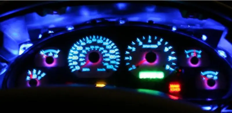

This is how it looks on mine :D
Note it's a little less bright in real life than on the picture.
Does anybody know what color bulb he used ( white or blue ) :shrug:

The face doesn't come off at all?! Nooo! I'll cut it off if I have to, I want to get it off and sand it down so I can get the white! And my middle knob of the three is the one that isn't coming off. If you look at my picture of the middle knob you can see at about the 11 o'clock position there is a white crack where the front started cracking as I tried to pry off that middle knob... It may match my stereo now but I'll be taking it out and putting in a carputer and I want a nice clean white. :nice:

Did any 01 guys get this to work right? I know the bulbs are white/clear and the guage overlay is tinted green..I cant see how the tri-led blue leds can power through the green enough to look really blue/bright.
Did mine tonight. I have the Steeda white face gauges on my 2002. Only disappointment was that the backing on the Steeda gauges has a green tint that is directly behind the white for the face so there is no way to get rid of the green.
Result is a little closer to an I dont know I guess you could call it like an aqua color or something?:shrug: Still way better than stock green and I didnt have any problems with my needles being dark.

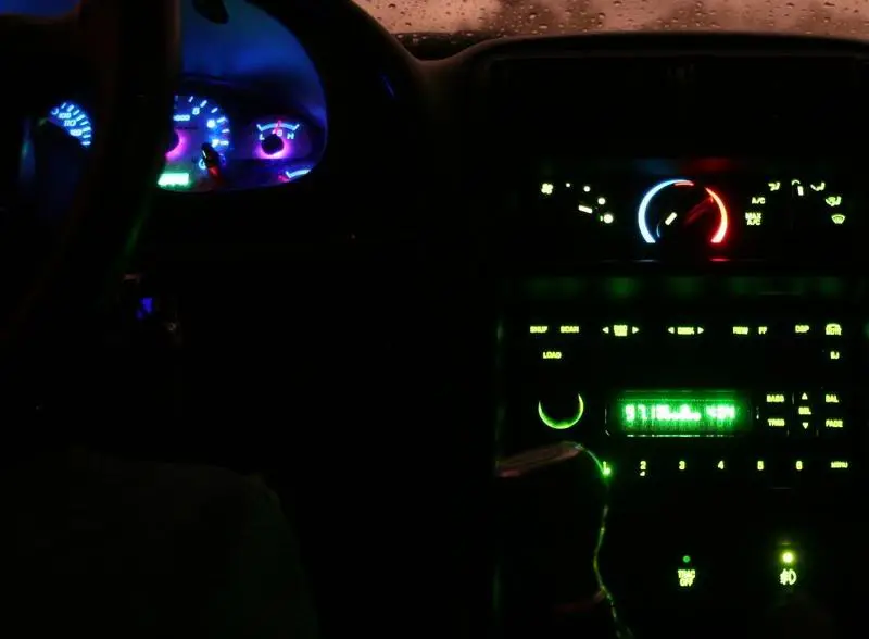

They look brighter in the pictures... My cameras night settings are retarded or maybe I just dont have it set right... but what ever. Has anyone else had any functional problems after doing this. During daytime driving my cd player, odometer and traction light(if its turned off) all go out when I hit my brakes... at night when my headlights are on it doesnt do this... any ideas??
Got the stuff in to finish doing the rest of my dash today. Was a pain in the.... but got it almost all done. Just have to rewire the leds in my defrost button they are wired backwards so its not coming on. I used 3mm blue leds for the switches and 5-led 194 wedge bulbs for the HVAC panel. The center console is about 3X as bright as my gauges turned out. It lights up my whole interior. Anyway, here are some pics.

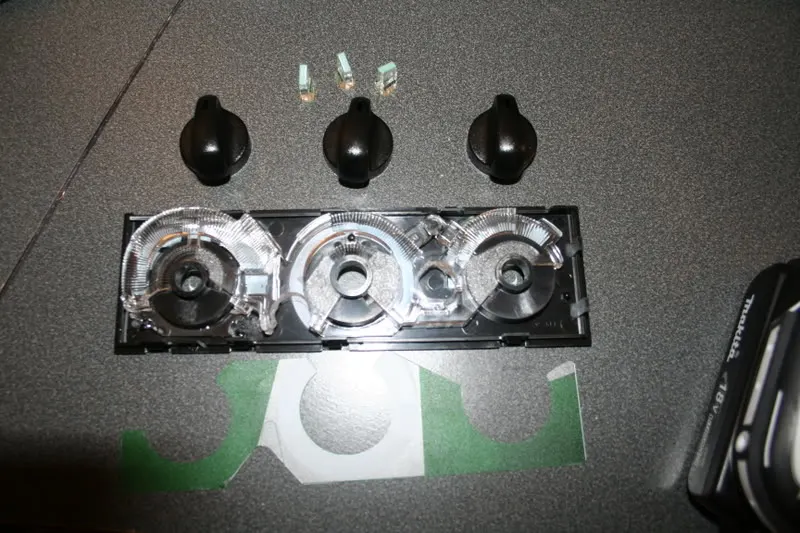

As for my HVAC's, turns out I just had to use a little force and outsmart those damn clips. Anyways, here's the result after taking off the tint!
Next plans are making some little inserts for those knobs, changing my defroster lights, then dome lights, map lights, a dimmer, and some led tubes. May even be painting the interior tomorrow!

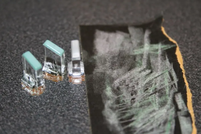

Cnpfreak88, I also pulled mine apart and removed the green. All you have to do with the knobs it pull out the little plastic pieces in them and sand down the tops.
As for my gauges its clear plastic with a green on the front and then the white over the green... only way to get rid of the green would be through the white. Only other option is to do the razor idea like you said, but I am not very motivated to tackle that just yet... :)

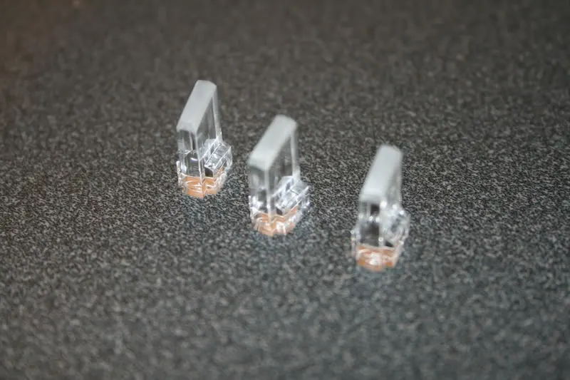

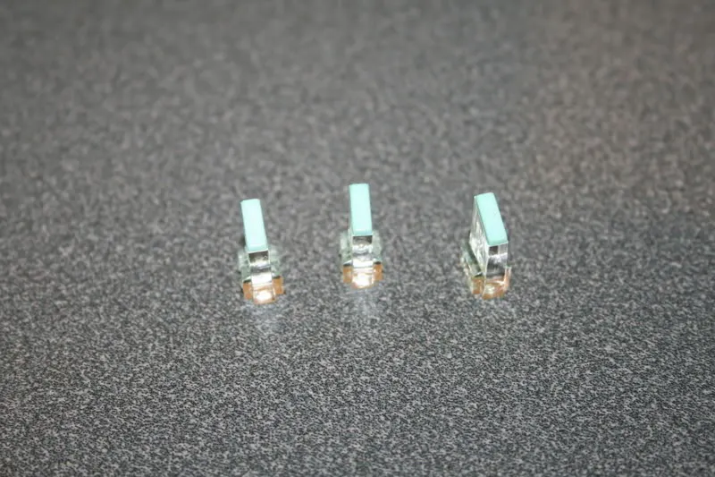

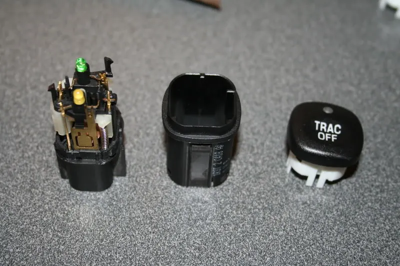

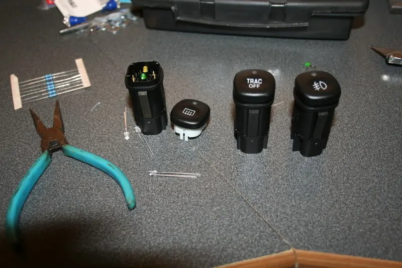

Also have you tackled the trac, defrost, and fog lights switches yet? If not I have some pics of them taken apart. I will post them here. If you check back to page ten of this thread you can see how they turned out. One of them isnt lit up in the picutres though because the led's are wired backward... grrr polarity... havent felt like pulling it back apart and switching it around.
here are pics.
Hmm... yours is different than mine, on mine there was a blue film behind and that whole plastic piece inside the knob is completely blue. On the 99-00 we don't have those switches on the center console so I don't have to do that, but my rear window defroster still has the green tint and a yellow light that I want to change so I'm gonna have to pull that off, other than that though I'm pretty satisfied with it! I actually just painted some of my interior pieces silver today.

I started down this path of changing the LEDS to blue but then later decided to do Speedhut over lays for the speedo and hvac. I did tear apart the Trac, Defrost, and Fog switches and put in 12 volt ready 3mm leds (Ordered them on ebay, they came with the resistor already soldered to the led). I saw a writeup in the 05 GT section about a guy that tore apart his stang to make it blue and he actually took apart the 6-cd player and changed those leds as well. I am going to try that in a couple of months and will post pics. I also ordered some silver/black HVAC knobs from MGW that had the red indicator on it so it matched my interior better. Here's a pic

Anyways, I'm taking apart my rear defroster button right now and it's kinda... weird... pulled off the button and the LED's are way in there. The LED for the words are from a twist-in bulb that just had a little rubber sock over it that I ripped off, but I'll probably end up replacing the bulb with an LED anyways. The other one is soldered to the board and I'll be replacing that one with a little red LED. Shouldn't be too bad though.
I put red LEDs in the switches. it was a 3mm from radioshack. and the think the resistors I used were around 580ohms. They put off stock like lighting. Not intrusive at all. It looks orange in the picture. But it is truly red. It matches my father inlaws Audi A8

I like the red look... I just went through all the trouble to change everything and actually decided yesterday I wanted to try red lights instead! The blue on my toggle switches turned out extremely bright! It lights up my whole car which I dont like. I am going to have to find some dimmer ones. Where did you say you got yours from? What was teh sellers ID on ebay so I can look them up. Mine came with resistors but not attached so it made for some interesting wiring in teh tiny little switches. As for the rest of my lights I am going to change them to incandescent because the LED's are screwing up my flasher module or something for some reason??:shrug: When my lights are on there is no problem but during the daytime when I hit my brakes my dash lights turn on and my cd player and odometer dim... then when I use my blinkers, I have sequentials, my interior lights and odometer flash with the sequencer... never had a problem until I changed all this to LED's. Any Ideas... :shrug: Oh I also have all LED's in my corners and my tail lights and reverse lights but they all have the correct load resistors on them and work perfect before my dash conversion. And they look Bada$$ at night! Sorry for the long post but any help would be appreciated.
I got my LED's from radio shack. I used around a 580ohm resistor, And I used incandencent in the HVAC. The blue part doesn't light up becasue the red light won't pass though it. Other then that, its a very even lighting thoughout the face. All you have to do it throw in some red incandecant bulbs in your hvac and solder some red LEDs and your done. I left the center film inside the HVAC. I think I may go back in and take it out though to see if I Can get the blue stripe to lite up even a little bit.
