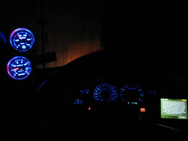

Finally got a shot of the Mach. obviously it works pretty good, no green or blue mess to mix the colors. i ripped out the green on the HVAC also, T/C Defrost and Fogs have been switched too. Even the bulb in the gear shift.

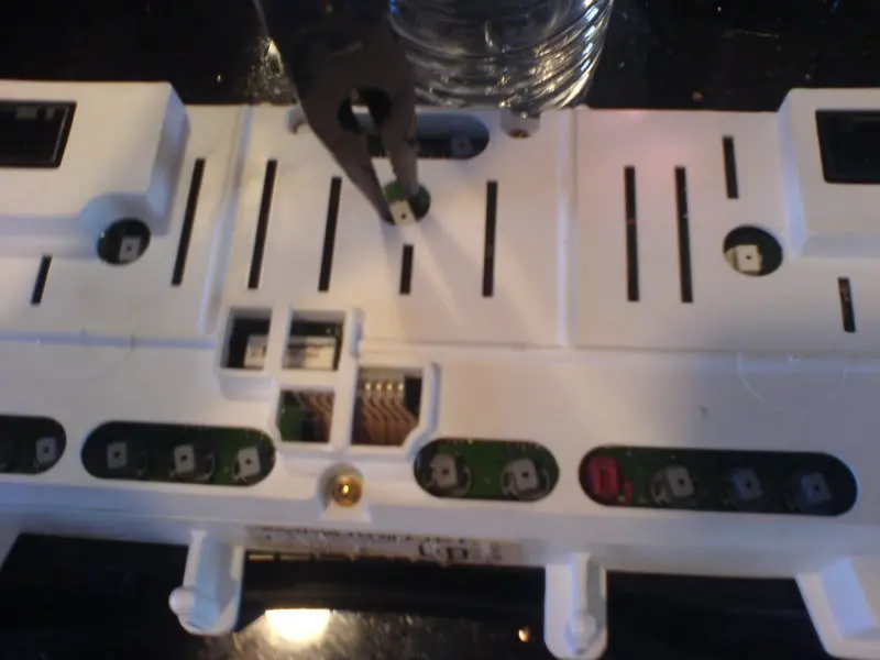

Okay, now you got your cluster out. Turn it over and you'll see all your sockets for the bulbs. There are 5. What you need to do is stick needle nose pliers into the sockets and twist a 1/4 turn to the left and pull out the socket:

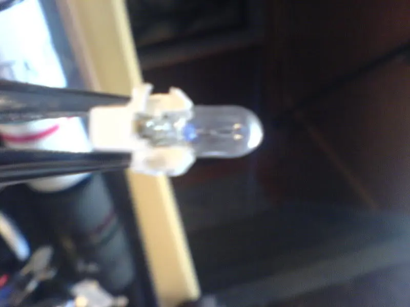

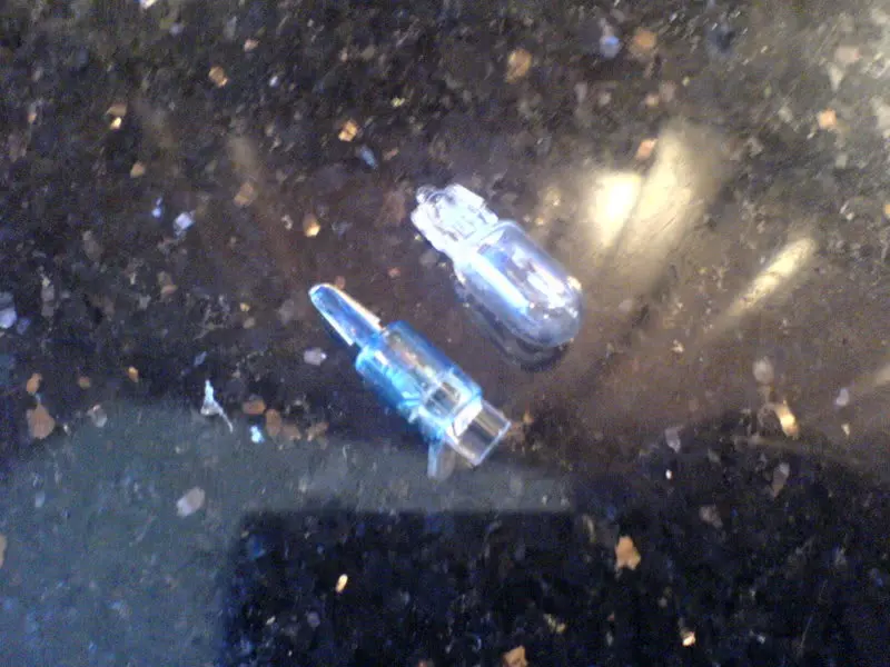

Next, take the socket and pull out the nasty bulb that's in it:

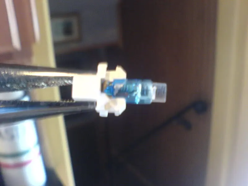

and replace it with one of your new LEDs:
to his:
Place back in the socket and twist. All done! Do this for all 5 bulbs.
*NOTE!!!! The LEDs have polarity!! So if you put them in and plug in your cluster and they don't light, take them out and turn around the LED within the socket. :nice: ***
Go ahead and put the cluster back in and you're all set! Here is what you'll have when you're all done:
Before:
After:
:nice:

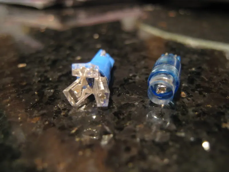

The Tri-LEDs light up the needles! :nice: What a difference in the brightness! No hotspots at ALL. Check out the difference in the LED itself:
I tried to get a shot to really show the illumination of the needles and no hotspots. I couldn't. I'm not a photographer. hehe So I decided to whip out the old digi-cam and take a quick video. Take a look at what it looks like. :nice:
YouTube - Tri-Led
It does make the blue look "white" but it's a deep blue like in the other pics. I know it still looks "dark" but when the camera gets close, that's the best representation of the illumination. The needles are clearly visible. :nice:!
