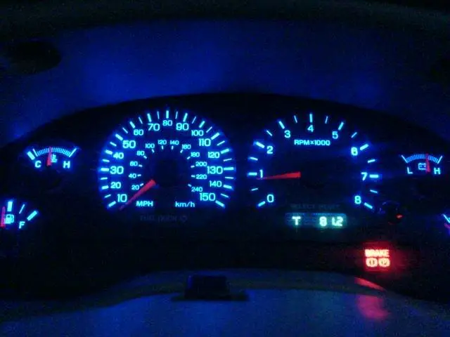

i went with the tri-leds blue for my oil psi and nos psi and WOW so bright i love them...now how many do you need for the cluster and for the ac control area, tri led of course but how many all together..???
tri-led's ftw!
for the cluster you need 5. for the ac control you need 2 i believe. but the ac is 168/194, not the smaller bulbs :nice:

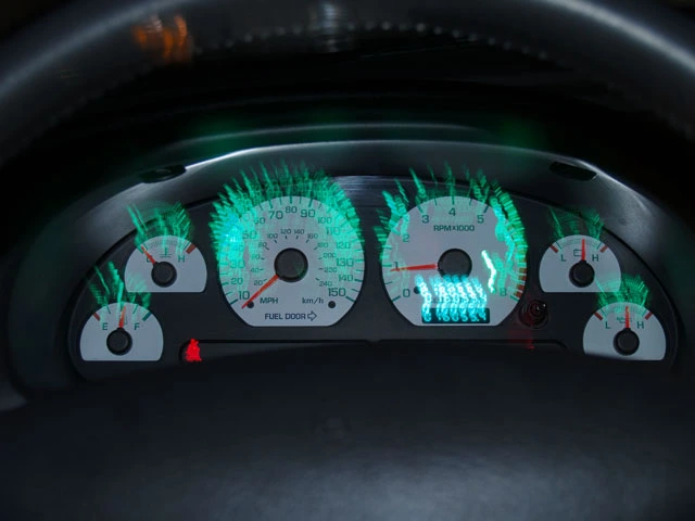

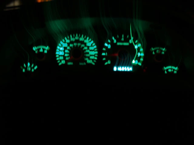

Ok as promised here are pics of the Green Tri-Led
the entire job took prolly 15 minutes. i did have a problem with polarity on some of the bulbs and i flipped them over to fix. with 14 minutes of it trying to get the headlight switch to come off the dash.
i didnt touch any of the needles or anything so if you are afraid of doing this mod because of that you have nothing to fear.

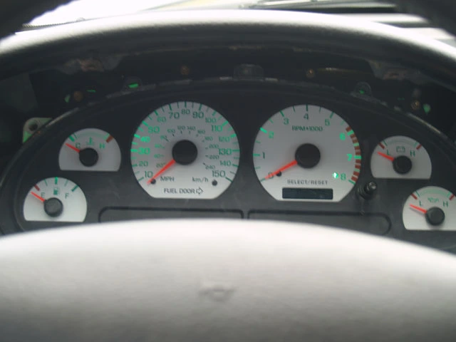

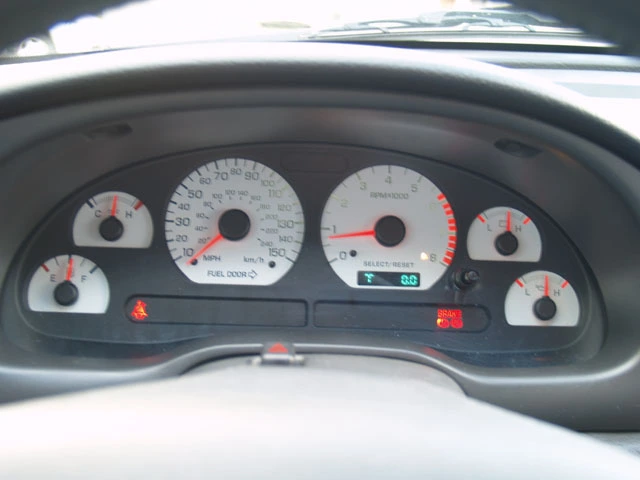

the first image you can see (kinda) that the left lights have burned out.

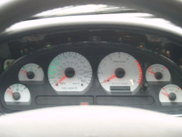

the second image the lights have been replaced on the left side, you can defintely see a difference in brightness
All the Lights have been swapped out
here is the pics at night with a flash on the camera
here is the pics at night with out a flash

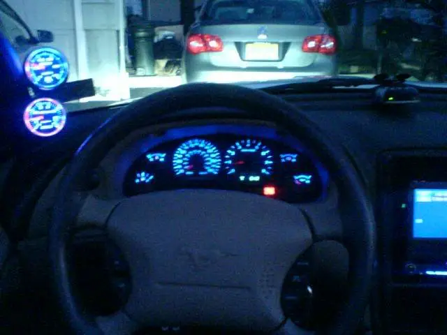

I snapped a few more shots yesterday for everyone. Sorry for the quality, cell cam. :p
