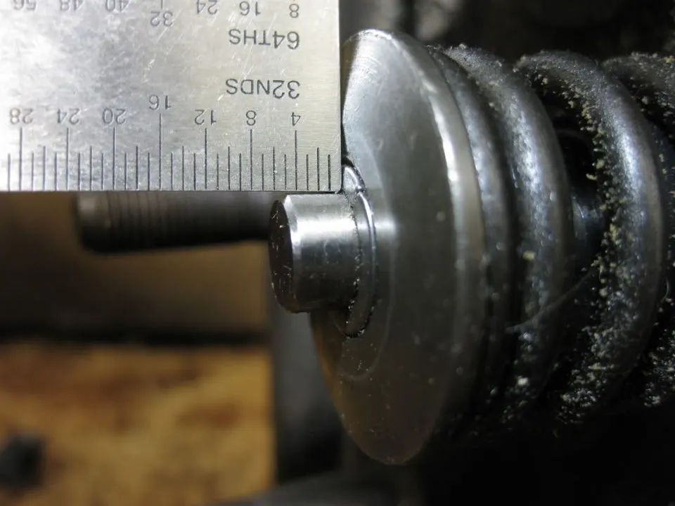

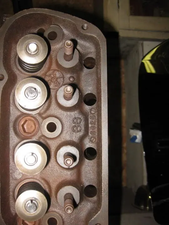

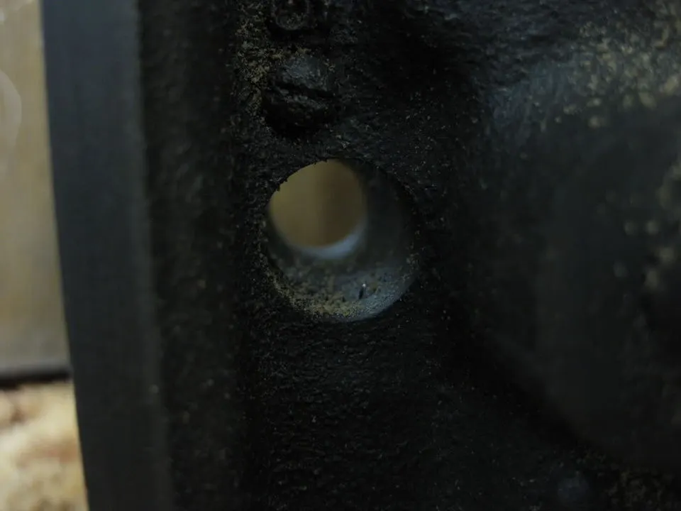

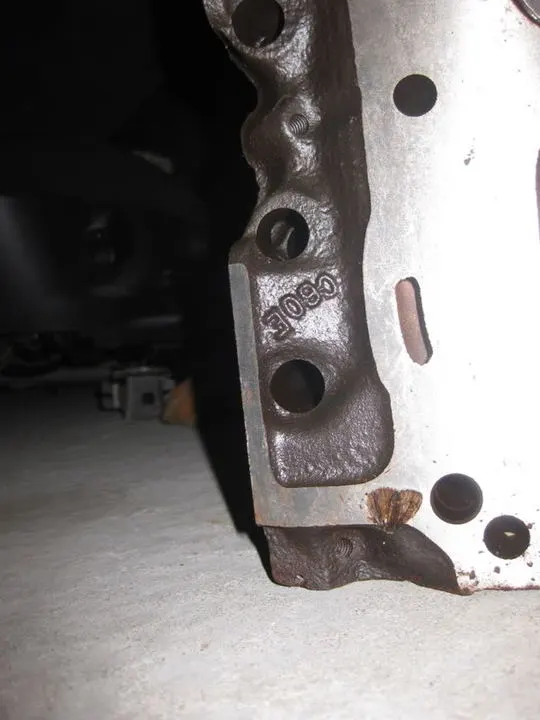

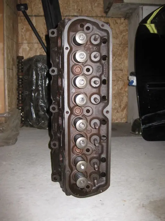

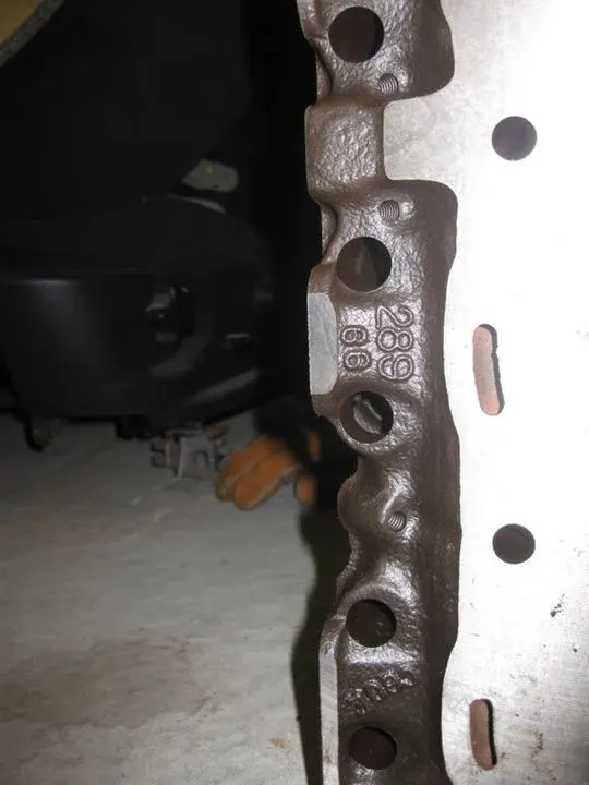

I read the date codes as March 66 heads. It's hard to see the pushrod slots with the camera angles, but there's something down the holes. The valve stem tops are also hard to identify as well with the camera angle. If you're going to run any cam larger than about a Comp Cam's 268H, then you'll need to replace the stock studs with screw in types. Bigger cams and the pressed in studs don't work well together. The stresses will work the studs out of the heads.
6G25 would be the later rail rocker heads, but the valve stems look to be too short for those in your pics. If you do have the pre rail rocker valves, then you're definately going to need to have screw in studs and guide plates installed to run the regular non rail rockers. The stems on the rail rocker heads protrude about a quarter inch above the valve stem retainers.
The cam is compatible with the stock pressed in studs, only you need to watch the compression ratio. No more than 9 to 1 with that cam, or you're going to have to run 93 octane premium fuel at a minimum. As for the rockers, if you're going to pay that much for stock rockers, I would do some looking around and find a set of (rail type)full roller rockers to work with those heads. Or at least buy a set of used stock rockers, those types just don't normally wear out.
:nono: Same retainers can also be found on pre rail heads too. Those look like aftermarket retainers anyway. ;) And with the 12 o'clock camera angle, the valve stems didn't look like rail stems. The stock pre rail retainers are different. Most of the rail retainers I've run across had the 2 pc jobs on the exhaust valves too.
