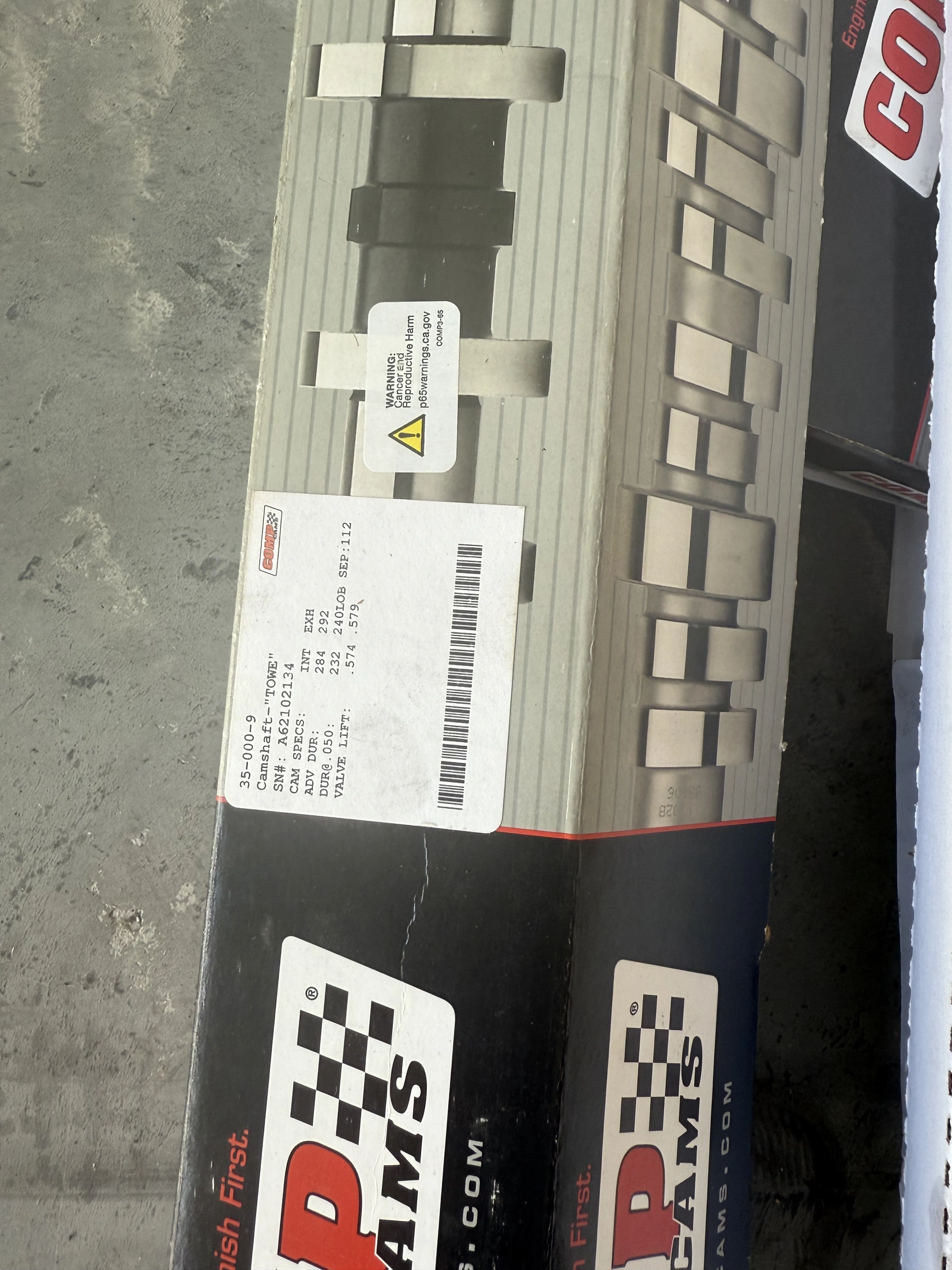

So this is my first time building a motor which is a 408 stroker . I’ve got a 93’ hatchback. I’ve got the short block built now I’m trying to figure out when length pushrods I’m going to need/ recommendations for lifters and roller rockers. Lifters I’ve been seeing morel link bar lifters and rockers I’ve seen a lot of people say comp cams ultra gold. If I were to go with these anyone have an idea what length pushrods I should go with ? Thank you
If you're doing a street build with hydro lifters, the dog bones will work just fine. You don't require the style with the built-in link bars.
