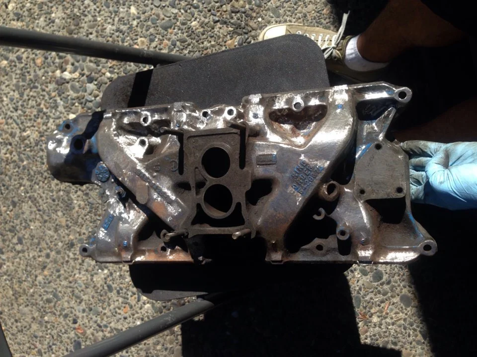

So im in the process of painting my engine and now I want to paint my intake manifold because it looks like crap. I dont know what kind of material it is but I think its iron. I think its fairly new, 2 yrs old maybe, but there are brown stains all over it. How should I go about cleaning it so I can spray paint it silver? Im using Hi-Temp engine paint.

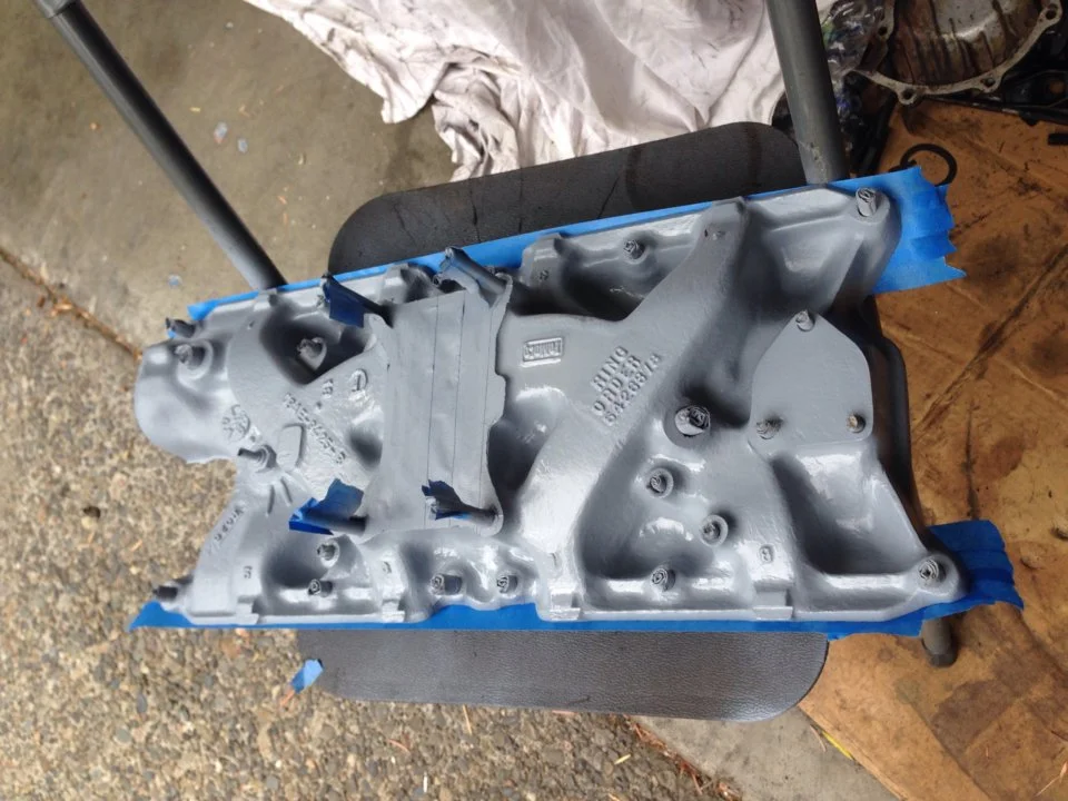

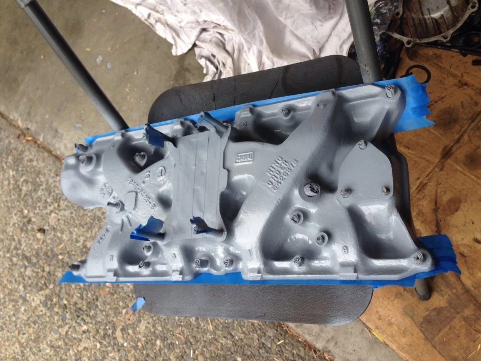

Either wire brush and drill/compressor for big spots and small brush for finer parts or here's what I did though it take time and commitment to get it done but it's not hard: get a dremel and 5pack of strong about one inch black sanding. Wheels and sand it down starting with open areas and getting to tighter spots when it wears down then use the cylinder for tighter areas and gray tip sander for small areas then the screw tip for inbetween the letters and smallest areas. If there's still rust or something left clean with naval jelly. It's really strong so don't breath or get on skin! Get a pipe cleaner or three of different sizes to scrub. Then after washing off with water take a tooth brush and engine degreaser and scrub the gold/brown residue free. Rinse with water later then use a clean shop towl and rub the metal to remove the minor tint. Let dry, tape up and roll binder paper half inch by size of holes and stick in all holes. Then prime it up and paint it.
