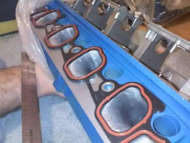

porting by me = free!! if you want to see pics of the port job i can post some up

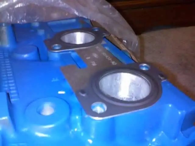

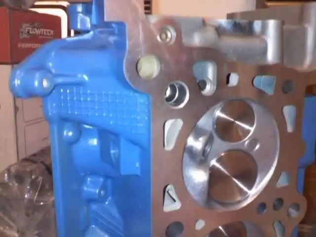

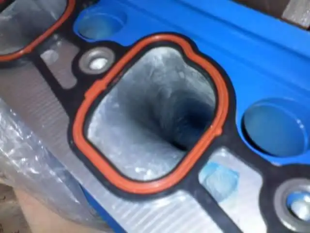

Aug 31, 2008
#36
  • Aug 31, 2008
  • #36
BurningRubber said:
I'd like to see some porting pics!!!
here's a few
dont mind the hairy leg
exhaust port with ford gasket
intake port with pi gasket

Try not to take this the wrong way…..
It’s not a horrible job, but they do look as though you rushed them a little. To be honest they still like they're a long way from being finished. There's still a lot of meat left in the ports on the intake side and I see tons of scuffs and gouges in the port walls on both sides.
The pics don't show any real comparison between the ports, but I really hope you were uniform in your porting and took your time. Nothing ruins a port job like inconsistency and just simply gasket matching the port openings doesn’t mean you’ve increased the flow substantially. Remember.....size and shaper are more important than volume in most cases. Especially in a N/A application. It’s wasn’t quite as easy as you thought it would be, is it?
I still think you would be further ahead right now to start fresh with a set of stock PI castings and just transfer your valve train over to them, but its your money.

you think theres still more to be taken out? because i wouldnt mind taking the valve train back out to do some more work and smooth them out some more, towards the end of them i did a little rushing, and yes i have atleat 10+ hours of work in them...
