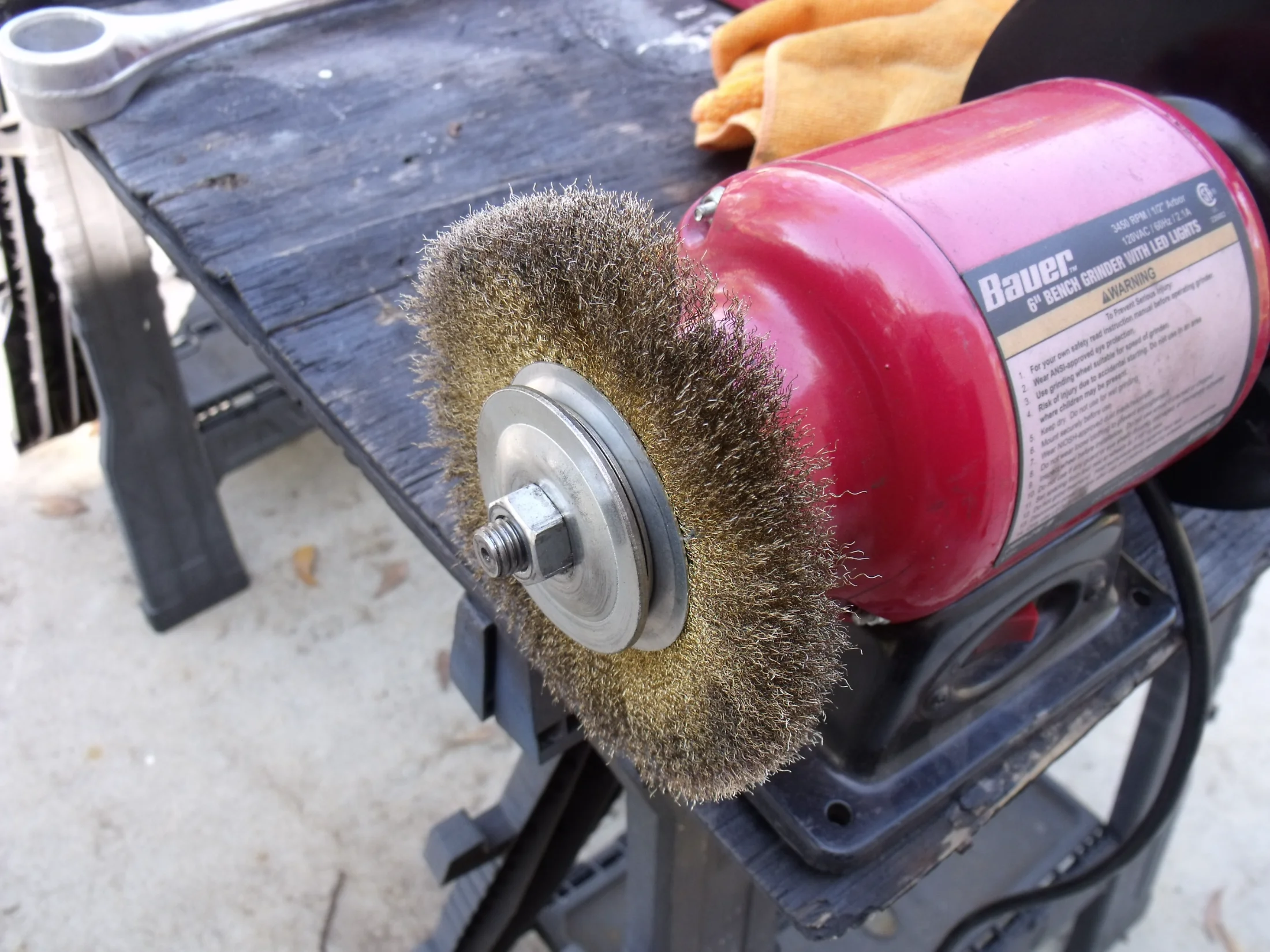

I want to clean the parts without scratching, removing parts numbers, or damaging them.. I have been looking at options and found a soft copper wire wheel on Amazon for my grinder... I tried it out today and it worked so well I wanted to pay it forward.....
Hope this helps others.....

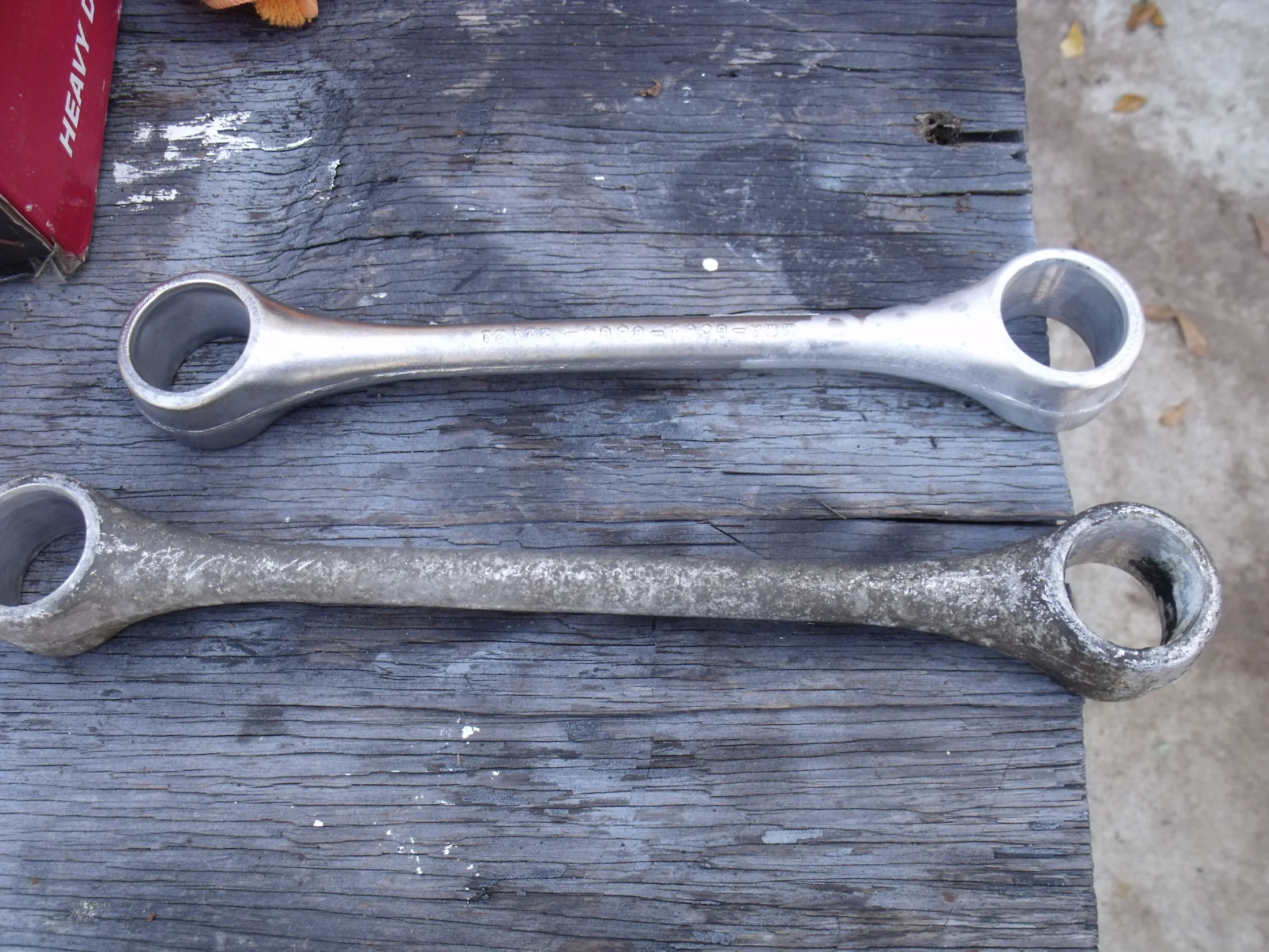

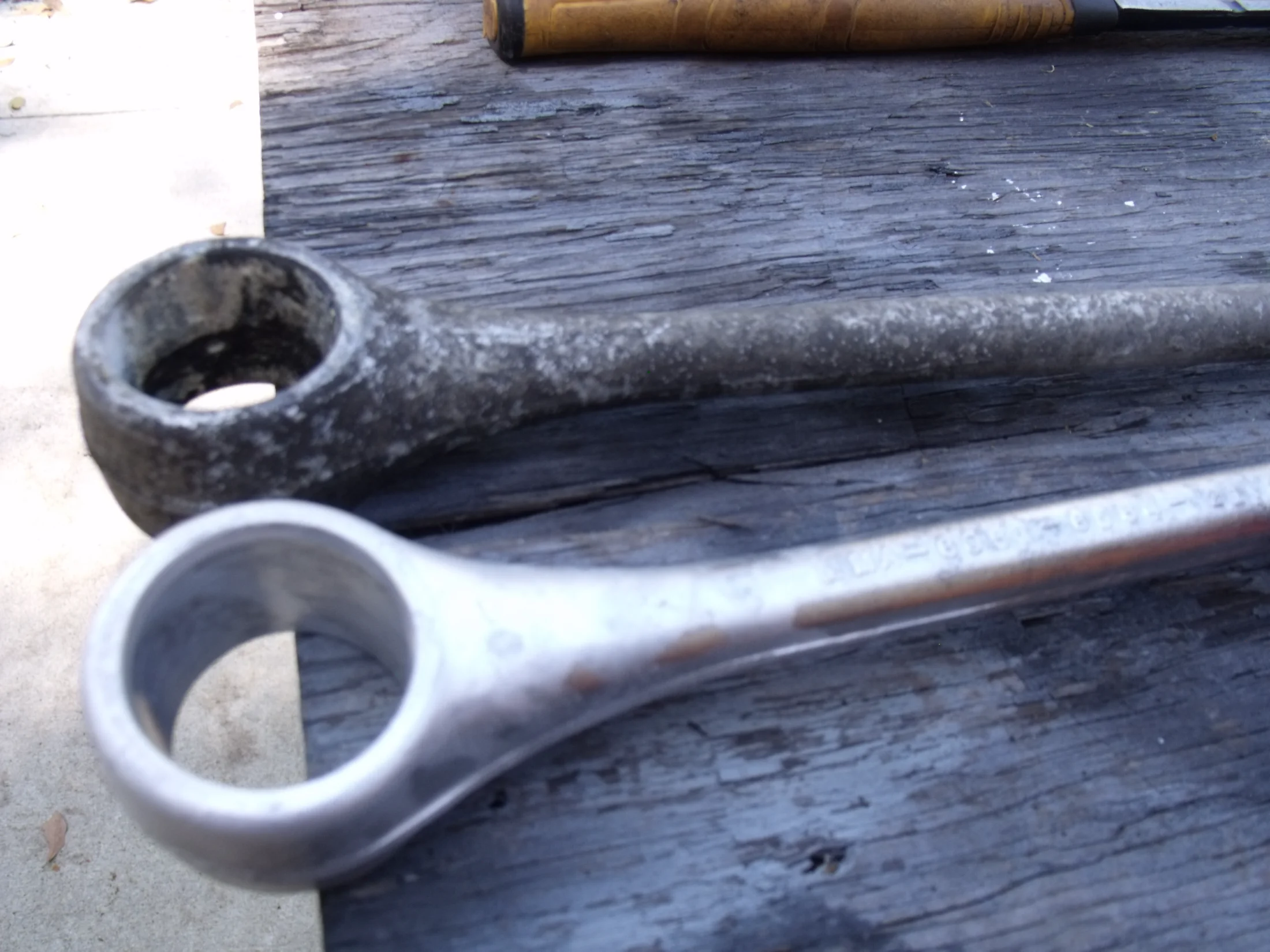

These are rear C4 suspension parts called " dog legs " .... The clean one was just a dirty as the " before " one....

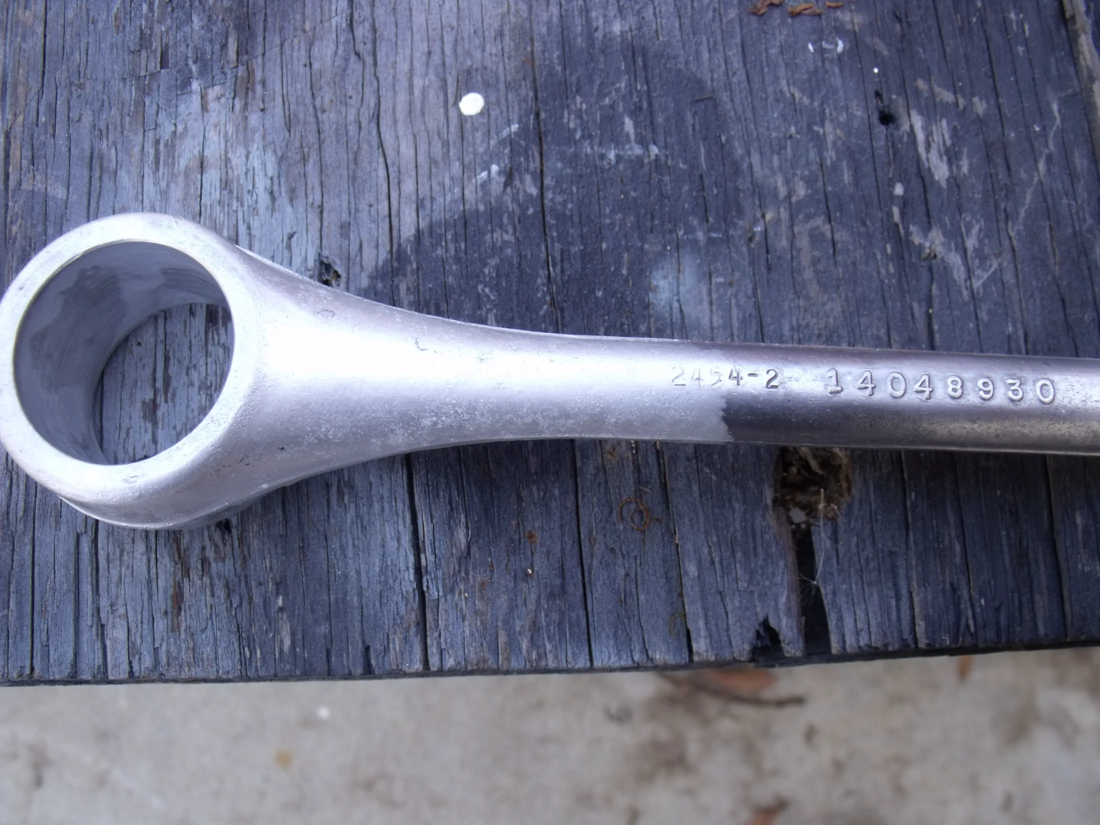

After using the copper wire wheel I sprayed some Napa Aluminum brightener on part of the clean dog leg.... Its the left side in the pic... Surprising the difference there also ....
I plan on cleaning them up with Acetone or Lacquer Thinner and painting them with some clear paint......

I started out soaking these in my Solvent tank, using Brillo pads, and red Scotchbrite.... Brillo pads would work with ALOT of work and ALOT of brillo pads.. A very nice surprise how well this copper wire wheel worked...
