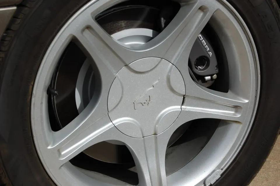

Hello everyone! I've been wanting to do this project since my Cobra front brake upgrade that I did last summer discolored on me and made me want to throw up every time I saw the front rotors. Hopefully this how to will help some fellow Stang people do the same project and freshen up their rotors. This could be done to the rear as well if you want, but my fronts were the ones that were the worst by a long shot. I was lazy and didn't do anything to the rotors when I installed the Cobra brake kit and paid for it. Here are some pics of the rotors with the wheels on the car (winter wheels) YIKES!!!!:

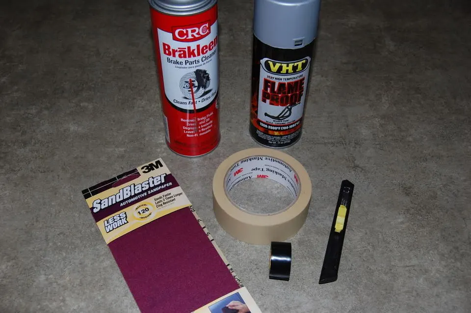

Here are most of the things I used to help me with the process (I forgot to take the pic before I used all the stuff):

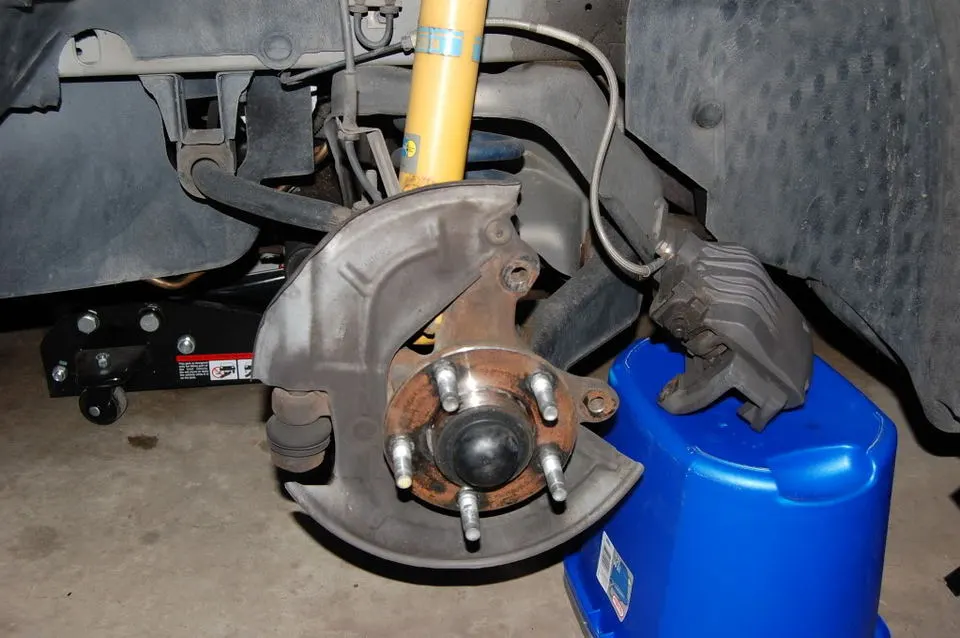

First off, jack up the front end of the car and place it on jackstands. Remove the wheels to expose the horror:
Remove the two caliper bracket retaining bolts on the back side of the caliper bracket and pull the caliper and bracket off of the rotor. Place on something tall like a bucket or suspend with a coat hanger, etc. Watch out for the brake lines as they can be fragile (especially stock rubber ones). Remove rotor from the hub by pulling or slightly pounding from the back with a rubber mallot:

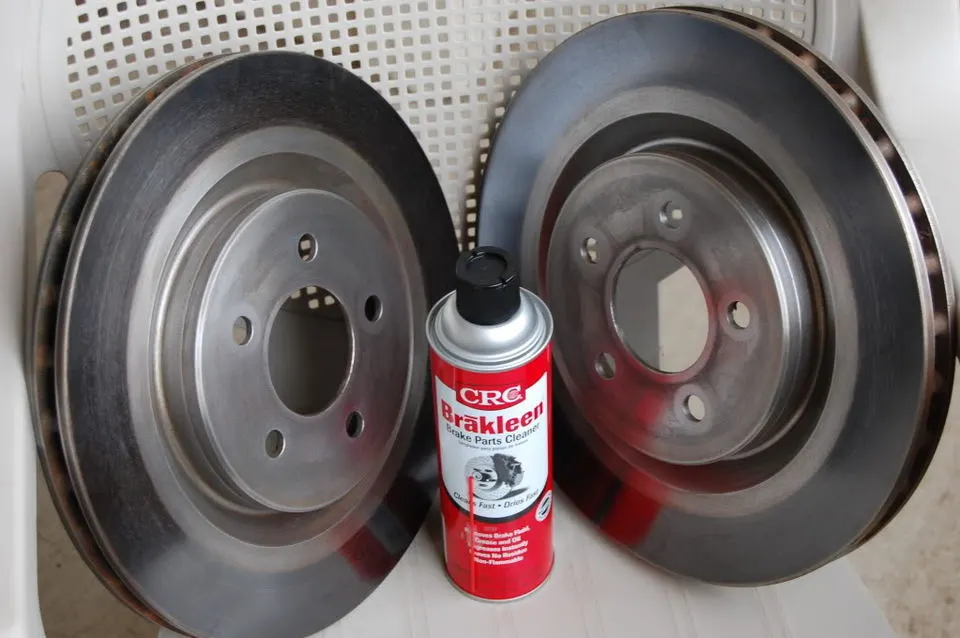

Take the rotors to an area you can work on them and sand down the problem areas. I used 120 grit automotive sandpaper because the staining seemed decently easy to get off. 120 worked like a charm. I sanded the inner section of the rotor including the hats and also sanded the edges of the rotors. I didn't get every bit of the discoloration off, but it was very much improved:
After this step, I put on rubber gloves (not shown) and cleaned the rotors off with brake cleaner to make sure there was no grease or hand oils on the surface that would interfere with the paint process. I ended up keeping the gloves on for the rest of the process through the painting steps:

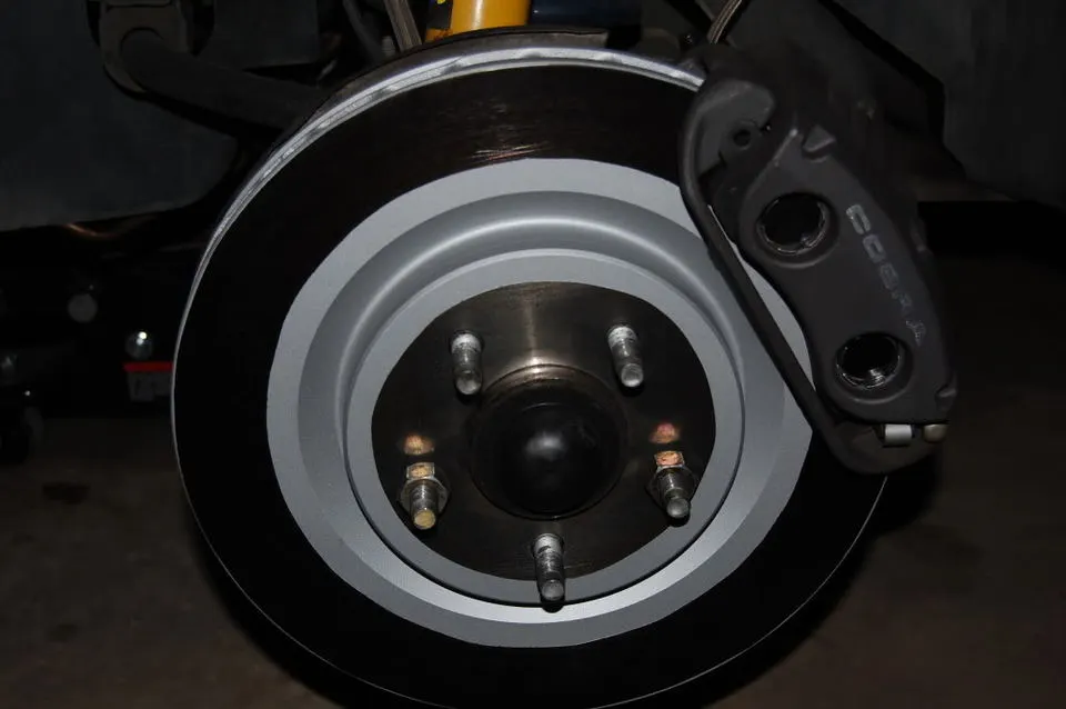

After cooling in my garage, I reversed the process to put the rotors back on the car. Here they are back on the hub with the caliper and bracket reattached:
And finally, the finished results with the wheels back on in the light! I'm very happy with the results and it took about 8 hours, but that included 3 hours or so of baking/cooling time. I can't wait to see what the FR500's look like back on the car!:
