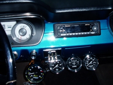

I cut my dash after much debate, I think it looks great. I thought about all the options mentioned already, and I just wanted to be able to put my hand up and put in a CD or turn up the volume.
Install was simple, used the cage as a template, then started at the hole from the original radio and started cutting with a small saw, once i got close to the line, i used a grinder to try and get as close to the line as i could. That way i got the cage to fit nice and tight.
