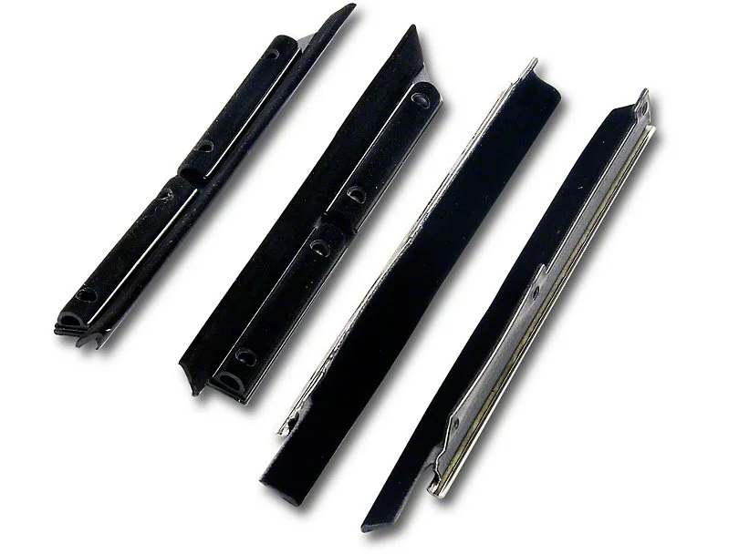

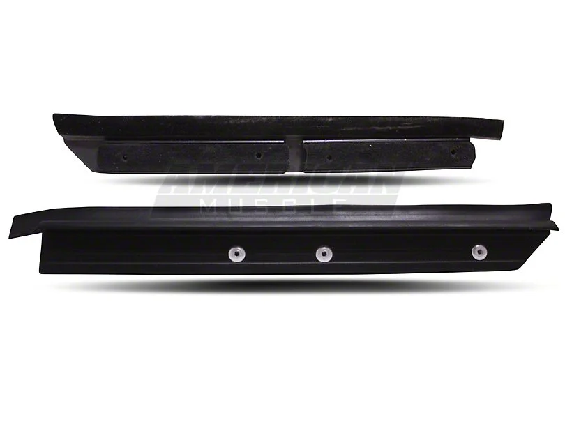

American Muscle sells the inner and outer weatherstrips in a kit
http://www.americanmuscle.com/inner-outer-quarterbelt-kit-8393-vert.html
inner and outer
outer
out
