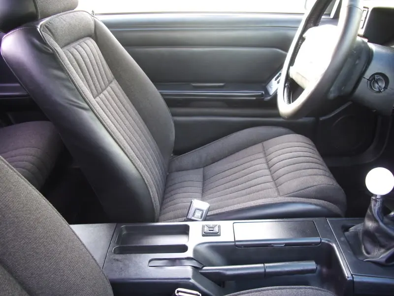

In this old crappy pic, you can kinda see how it's not straight. The console side of the seat is what leans back too far.
