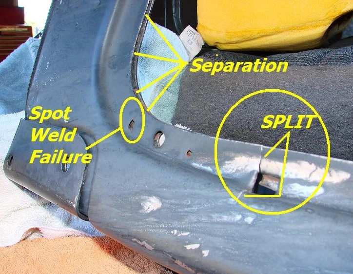

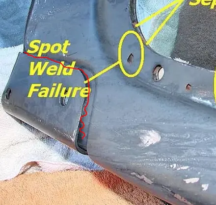

Places to look.
I welded my old seat up. It was cracked and spot welds had failed. Used a HF welding machine. Worked well and didn't fail again. With the turbo couoe seats I have in my mustang now I try to keep from shifting weight at my left shoulder when banging gears. Years ago ( 90s easy 2000s ) you'd see folks at the track with stuff wedged behind the seat. A couple friends of mine have totalled mustangs because of seat failures. I was there when one of them hooked up and next thing you saw was him air grabbing for the steering wheel. Didn't end up good at all.

You might check here , this was the problem I had.

Almost Stock—Thanks for that picture and info. I will look to see if there’s any crack in that area.

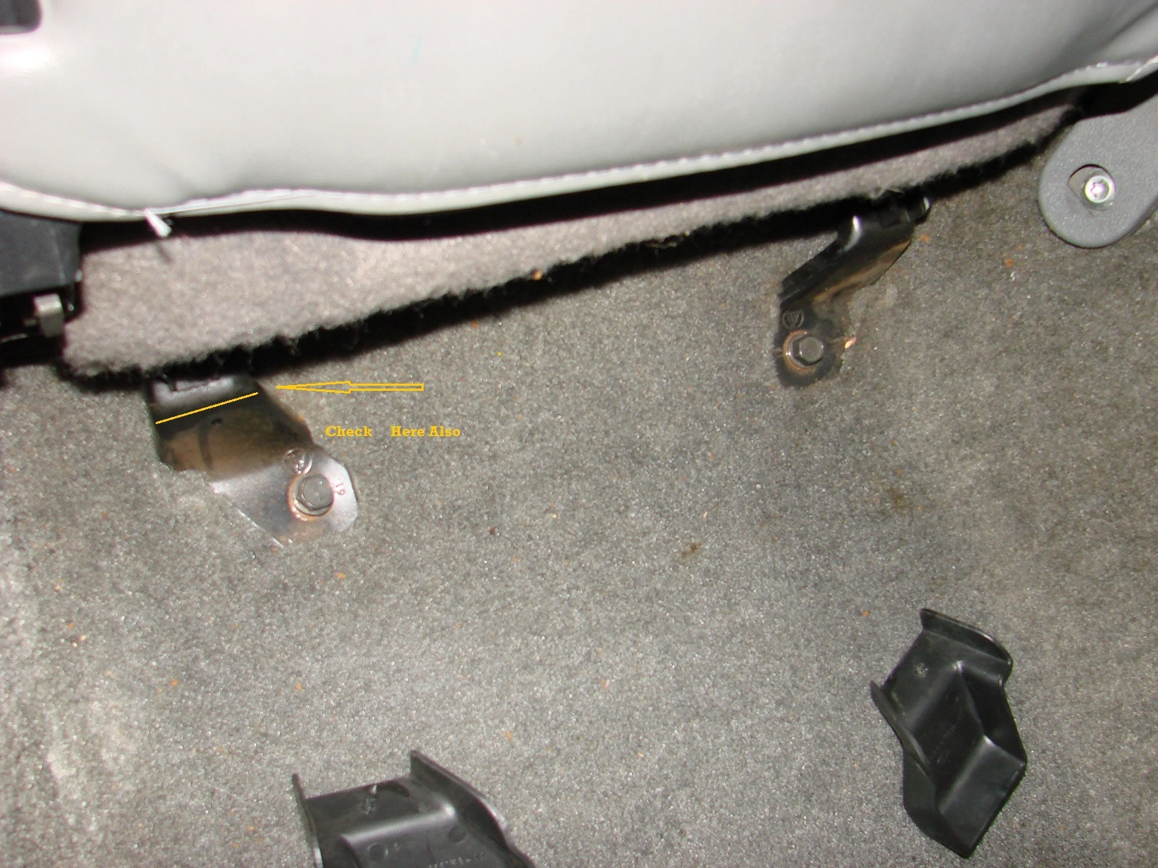

I had that gangster lean and it turned out to be a tear in the metal securing the front seat stud. I bought that reinforcement bracket from LMR and now it's rock solid. My only issue is the kit lifts the front portion of the seat up slightly so leg and head room can be a pain if you are a tall or big guy like myself.
Started on this yesterday. Noticed a small hairline crack (1/4) inch in the flloor pan, but when I applied force I saw no flex. Will check out the seat frame next and report back.
