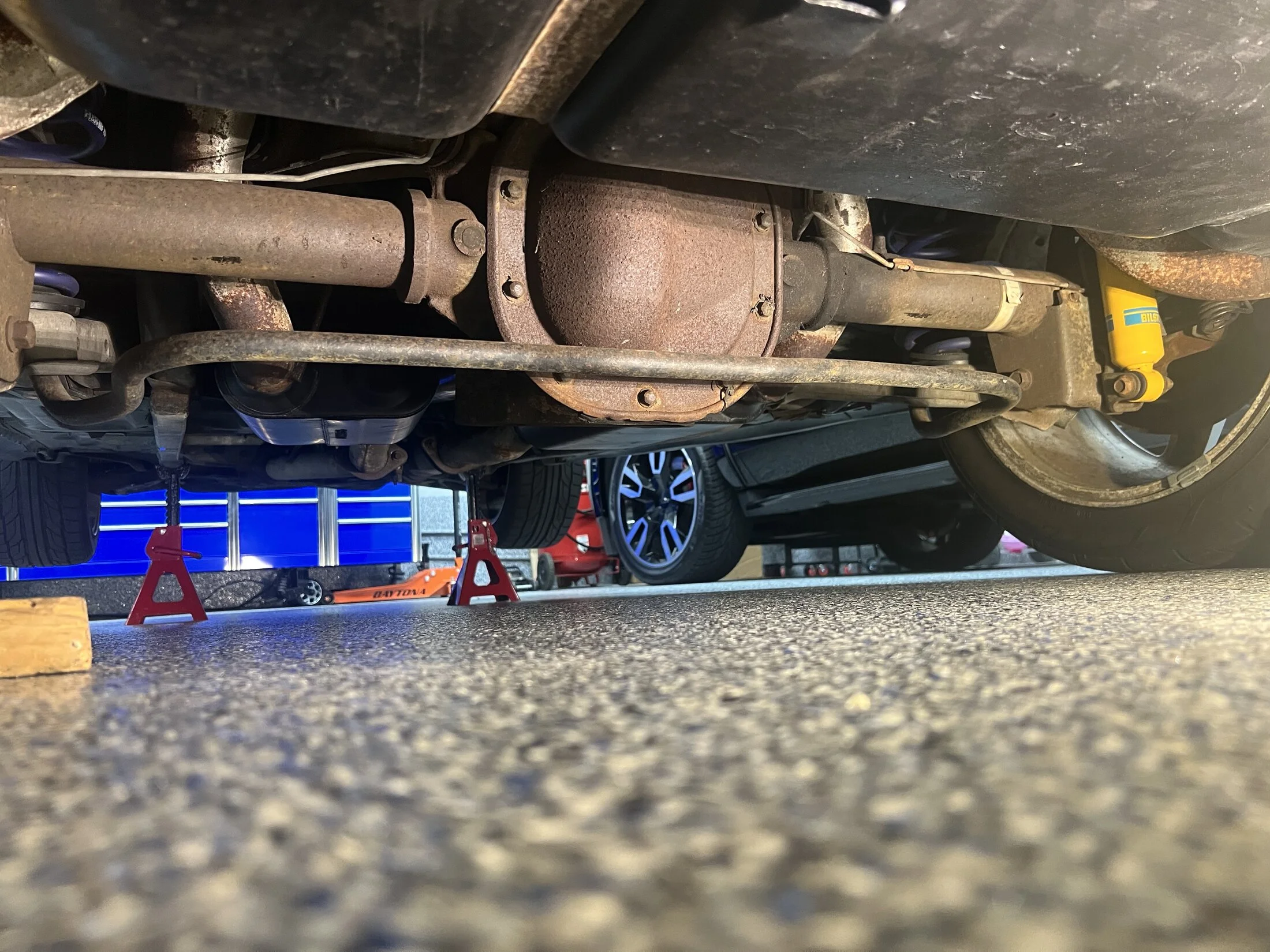

The reason I ask is I am seeing some rubbing on the front side of the axle housing directly behind the H&R springs (picture in Post #19). This is not normal at all. If the bushings in any of the four control arms are bad then your pinion angle it going to go all over the place and the rear end will move all kinds of funky. IF they are all stock then you could very well have bushing issues that is causing some really unpredictable drive train geometry which could account for the DS contact.
If all of the bushings are in good order then just download the TREMEC Toolbox App and it has a pinion angle finder in it which will get you close enough.
Give us a shot of the rear axle in the car

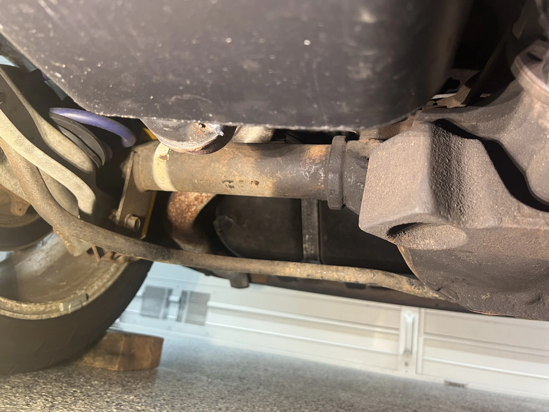

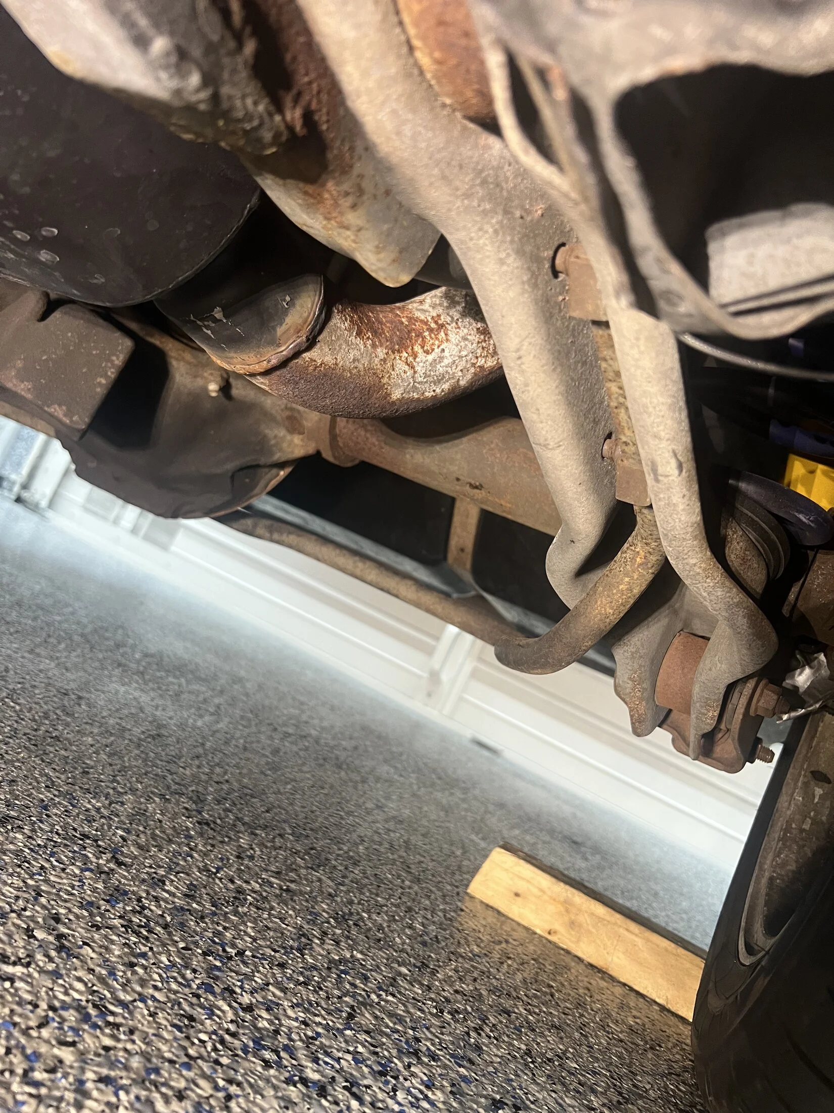

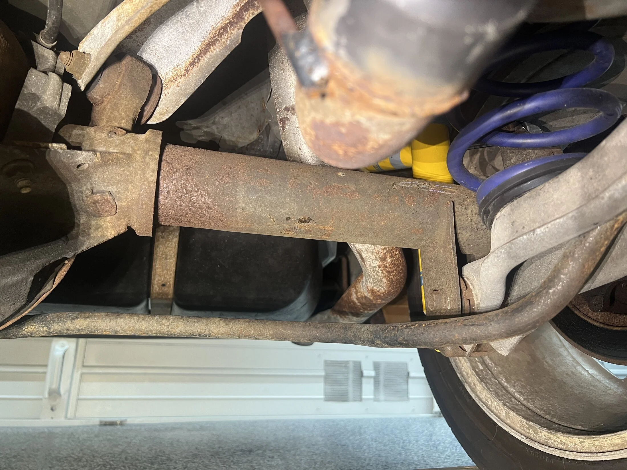

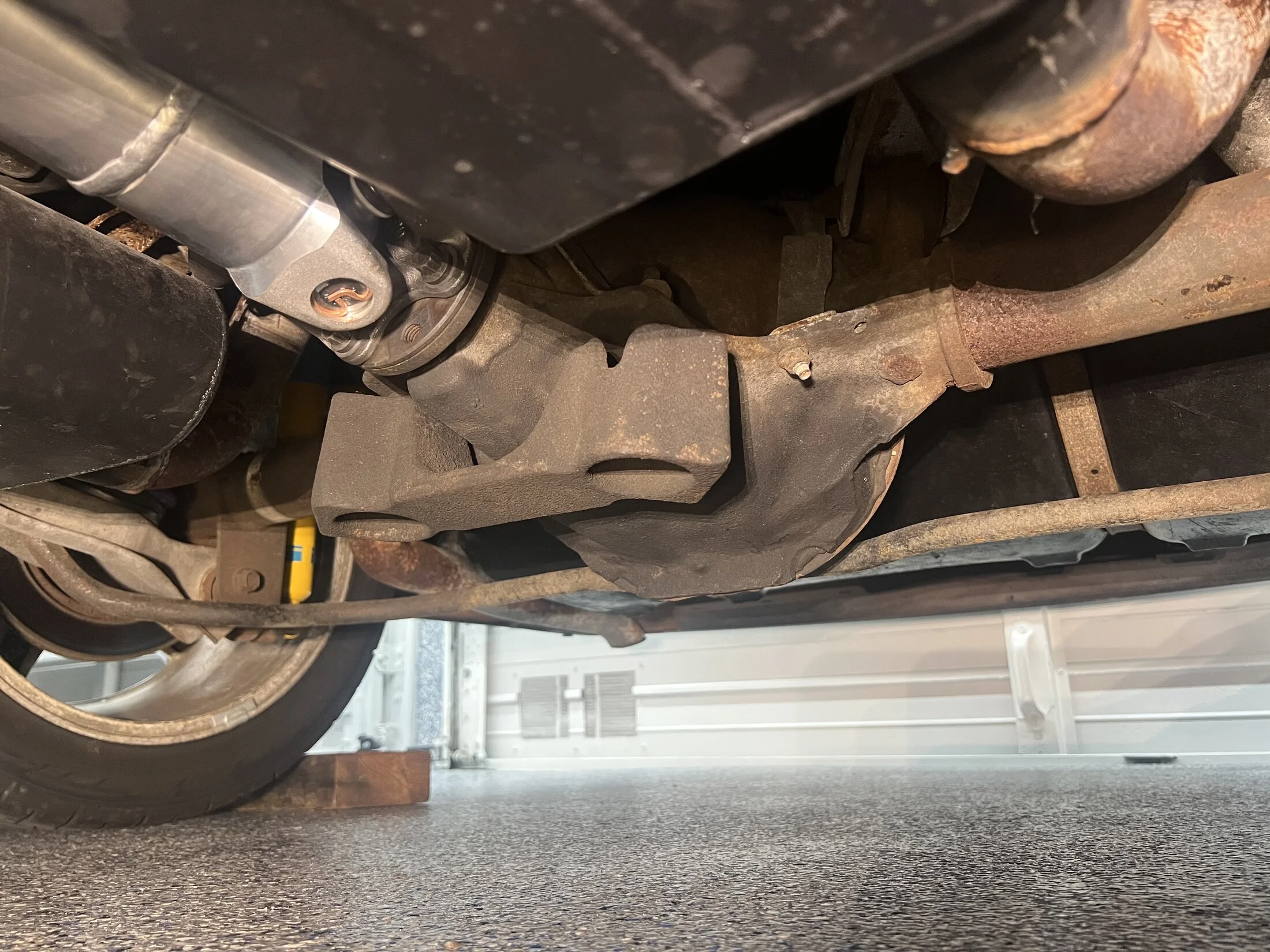

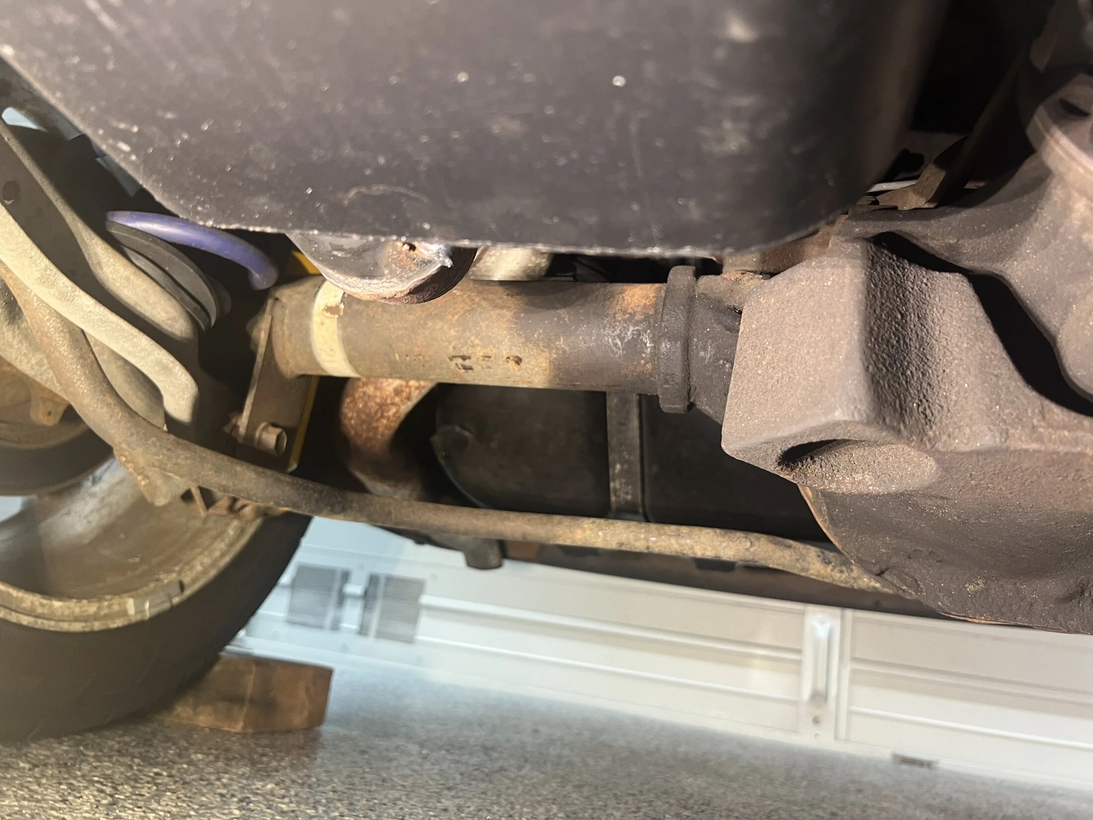

Here’s some pics

Good eye! Yes all of the control arms are stock so this very well could be part of the issue here. I’m thinking I’ll install the MM upper and lower control arms.
I’m thinking I should get the adjustable LCA’s so that worst case scenario if the DS is still rubbing I could just raise the rear up a bit. Would that work?

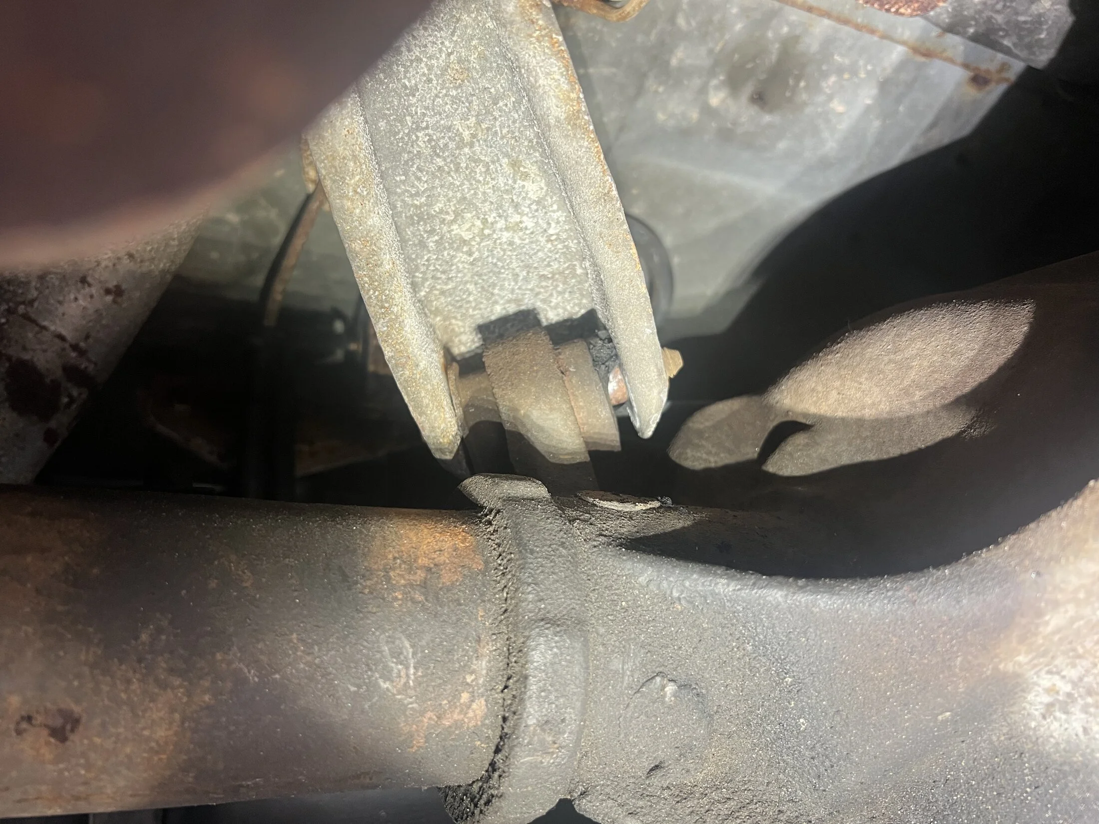

Second to last picture. The UCA bushings that are pressed into the rear end are destroyed. Get some Moog units and replace the old ones.
If you can swing the new control arms you won’t regret it. My guess is the remaining six bushings in the rock control arms are in bad shape as well. This is most likely the source of your problems.
Yea I thought that one looked bad. Well that’s good to know. Yea I’ll most likely just get new control arms.

Those upper bushings on the control arms are shot like previously said.
What is likely happening is that under load, the front of the differential is lifting as the tires push the car forward and the rear squats. That causes the driveshaft end near the diff to lift higher in the transmission tunnel, creating your issue.
Likely, fixing your bushing issues will solve the problem, although to do need to address the cracks in the floor.
