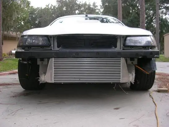

Remember to run a massive intercooler!!!
...like mine:
...like mine:
...like mine:
w00t ebay FMIC FTW! I ran the same (well, looks exactly the same) core on my 97 Eclipse GST Spyder with awesome results. one day we were able to rig a post-IC IAT and log it via DSMlink, and compared to a spearco of the same design and size, mine was showing temps of 10-20* cooler and had less pressure drop(IE pressure read at maf as compared to pressure read at GM 3bar MAP sensor on the manifold). Plus the other guy spend 1000$ on his kit before piping, i spend 300$ total.
