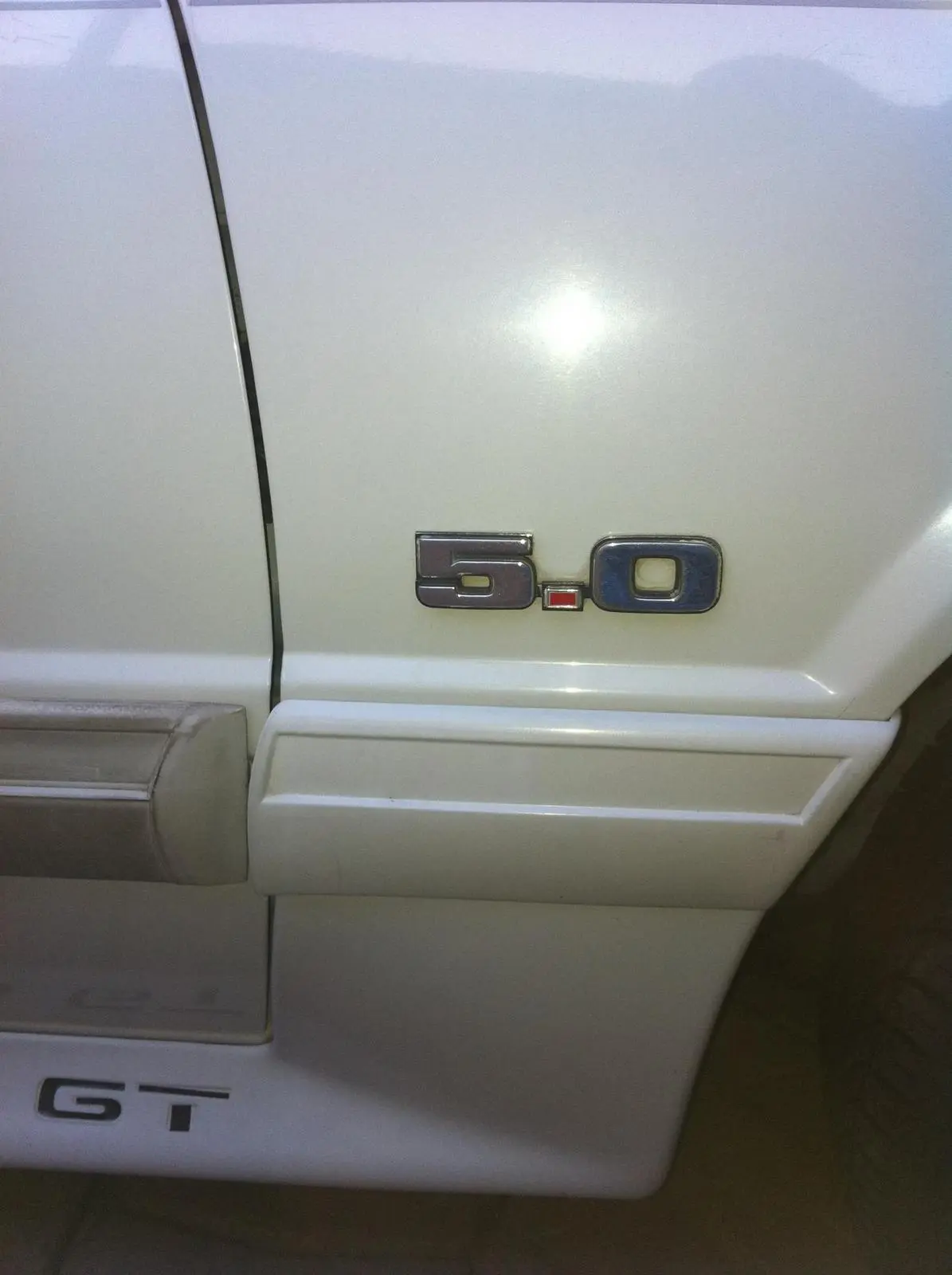

I am going to change out my old 5.0 fender emblems and replace them with the new 2011 5.0 emblems. What is the best way to get off the old ones without messing up fender or old emblems?

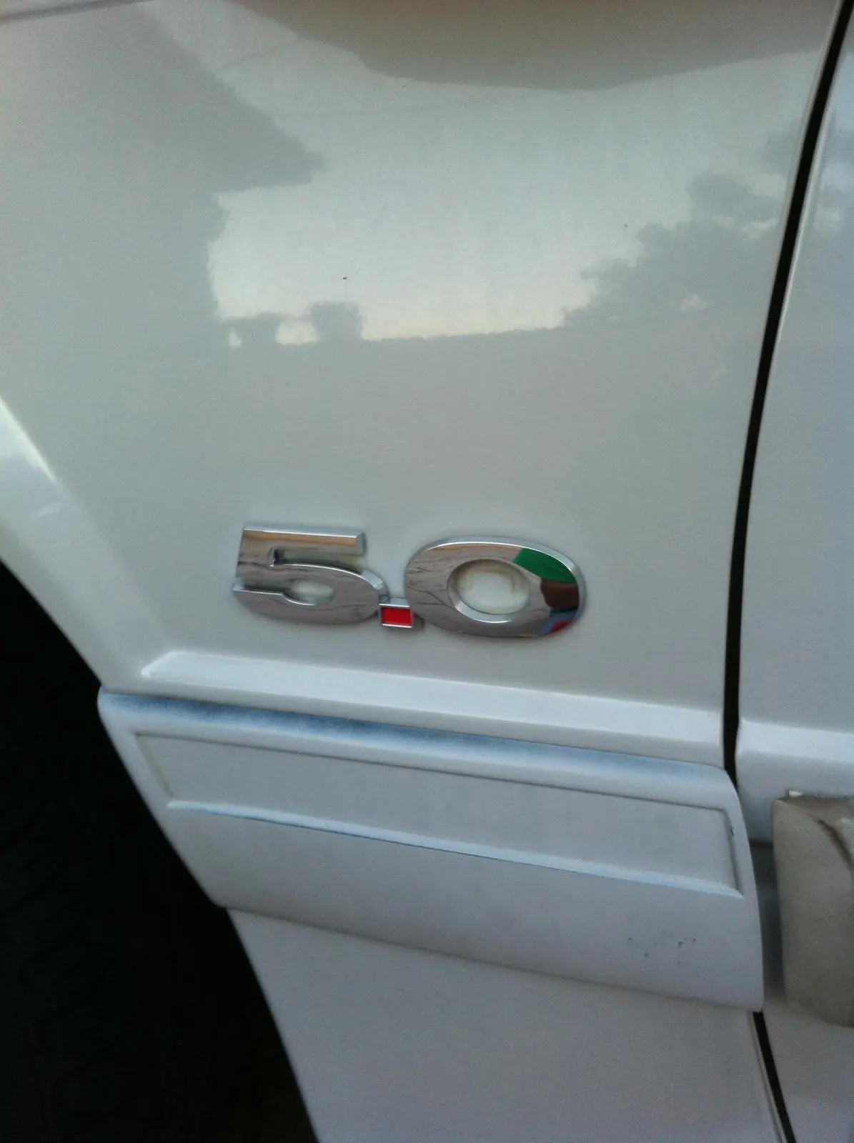

You know what? That looks pretty damn good!
I saw a dark blue GT with 11' emblems and I didn't like the look
Yours however has a fresh clean look to it.....Oh the little things lol
