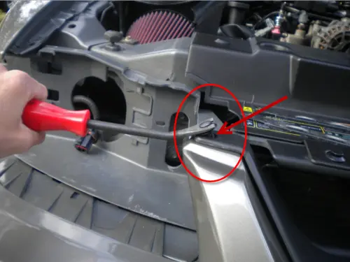

I found it easier to take the headlights off before removing the cover as well. These come out by removing the 2 slide retainers on the back side and disconnecting the wiring plugs. Be careful with the header panel when installing the Mach 1 grill delete.
That push pin is a pain to get out and if you pry too hard, the tab on the header panel below it will break. You then have to replace the entire header panel or get creative with a fix.
