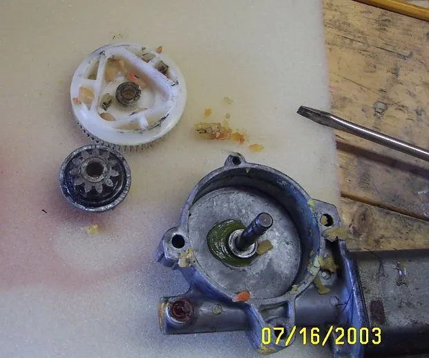

With the cover off you can see the mess of chewed plastic bushings. Clean all the bushing material up.
Remove the gear ring. This will be a pain. I used to small nails. Stick in the holes and pull out. You will figure you own way when you get there.
Now pull the steel gear out. Also pull the white plastic gear out. At this point you can just purchase an entire gear kit from Cardone. Part number is 42-94 and costs around $20 (easier way). There is no assembly required with this route. Or you can go to the dealer and get plastic bushings like I'm installing here for $13.

Good stuff...Here are a couple from mine.
All those little broken pieces need to be removed. I use a Shop Vac. If those pieces are left behind, they can jam up the gears later

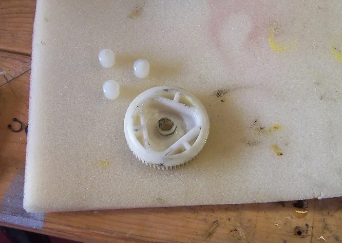

These are what those pieces use to look like. They go in each corner of the plastic gear inner triangle, and the metal gear fits snuggly inside. Be sure to add plenty of lube on all the gear surfaces!

Awesome picture of the inside of the gearbox. I am wondering how 94GTLaserRC got ahold of those three little round plastic pieces the go inside the gear box. If anyone knows an address, web address or any piece of information that partains to obtaining these, would you please post that information or you can email me from this site. I have allowed others to send emails.
Thanks all, have a wonderful day.
At the time I bought the whole gear replacement from Ford for about $20...Way more than they cost now, but worth it at the time. I think I wanna make and market these..they seem to be hard to find and high in demand.
