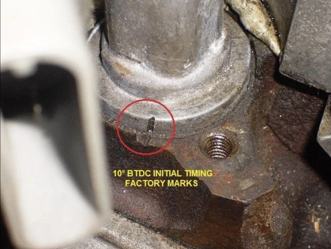

I think it’s the notch at the base of the distributor. Found this pic of it and my OEM has it as well.
I have read somewhere the significance of the mark but don’t remember off hand. I want to say it lines up with the bolt hole for the hold down but I’m not 100%.
I saw that too, couldnt remember if I did that as a teen or not. Been too many years!!
All of the OEM distributors have that, same with the block. Im not sure if aftermarket distributors have that notch?
