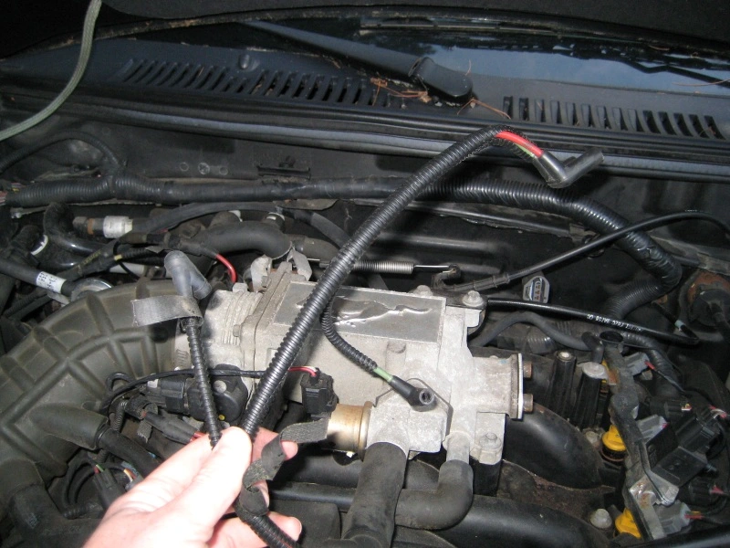

In the first one, these are the vacuum tubes. I can't just remove them due to the lines going down to the passenger side. Can I just plug them, wind them up and stick them out of the way? or is it possible to actually remove it. If plugging is the way to go, what's my best option?

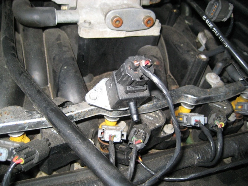

Now this is where a vacuum line plugged in, a cap should do the trick, right?
and the disconnected plug in the rear can just be hidden away as well?

Trace the un-used vacuum lines back across to the passenger side. You will have to cut the wire loom off. When you trace it back to the passenger side, cut it to where the vacuum line is not noticable. Then, heat up the end where you cut it with a lighter, lick your fingers, and pinch down on the end real quick. Do that a few times and it will be sealed just fine.
