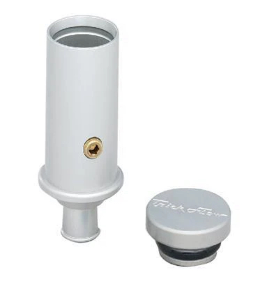

Well, I’ve been having issues with oil getting into the intake and decided to start diving into it. My car has trickflow heads with the trickflow valve cover. The TF valve cover has no baffle in it. The genius owner before me decided to mount the oil filler tube right above a rocker arm. The TF filler tube has a nipple for a vacuum hose that mounts to it and goes into the intake. So the oil is shooting up through there and getting sucked into the intake.
Any thoughts on the best way to fix this?
Plug the nipple and don’t run the vacuum line from the filler neck? Would this cause an issue with the Pcv system?
Buy a new valve cover and just move the filler tube to the end?
Filler neck:
Is the oil in your intake right behind the TB or further down (above the driver side valve cover)?

You can see oil dripping from the TB onto the valve cover. It’s all over the throttle cable underneath. When I removed the cobra intake there was a little oil behind the TB and above where it mounts to the lower intake. Oil is being pushed up from the filler neck through the PCV hose. When I pulled the filler neck off you can see the rocker arm right under it. No baffle Nothing. From what I read the Tricklflow valve covers do not have baffles and you want to mount the neck in an area to avoid oil shooting back up through the filler. Obviously, you don’t want it above a rocker.
