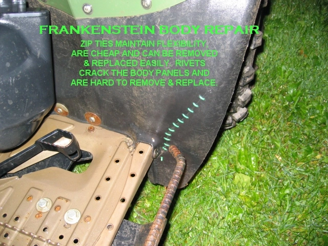

Zip-tie Frankenstein stitches. :D I don't have a pic of it on my car, but my front bumper has a tear in it underneath where you can't see and that's what I'm doing for the time being.
Best pic of what I'm talking about that I could find:
