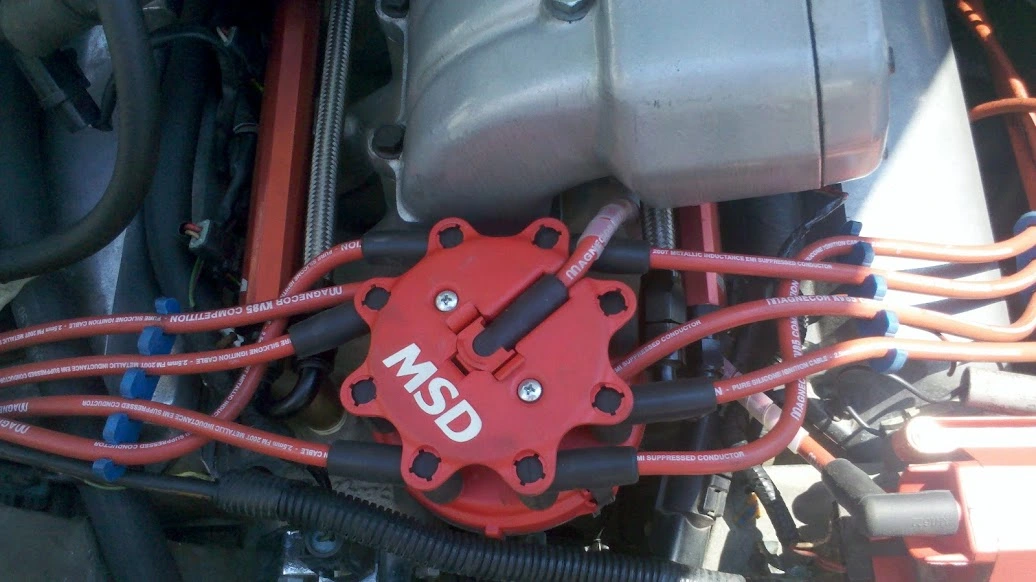

My question is how do you route your spark plug wires the Ford way I saw something on another form They mention that this was the Ford way to route your spark plug wires you'll have 1 and 6 do a little S maneuver like this.
It's important because crossfire can hurt your engine? Is this true?

It doesn't matter what they look like, just route the 5 and 6 so they don't leave the distributor next to each other and they're at opposite ends of the separator looms the whole way down.
