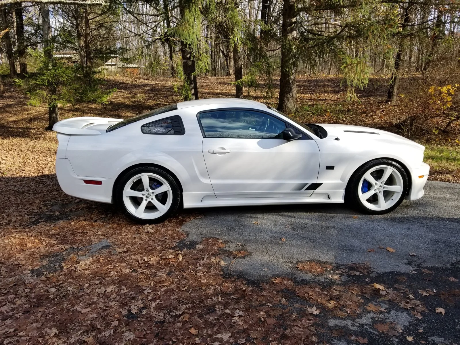

I have a stock 2007 Supercharged Saleen. I know it comes down to driver mod, air, 60ft.... but was wondering what is a decent recipe to knock off consistent high 11s? Bone stock on all season tires with :poo:ty Saleen tune with 3.8 pulley I ran 13.1 @108 with a 2.1 60.
I'm going to be installing "brenspeed" stage 3 upgrade which includes (3.4 pulley 8-9lbs boost, KB boost a pump, jlt cold air. Is it possible to do with stock headers?
Will I need upper/lower control arms?
Which rear tires on the big 20inch saleen wheels? Thank you in advace.
