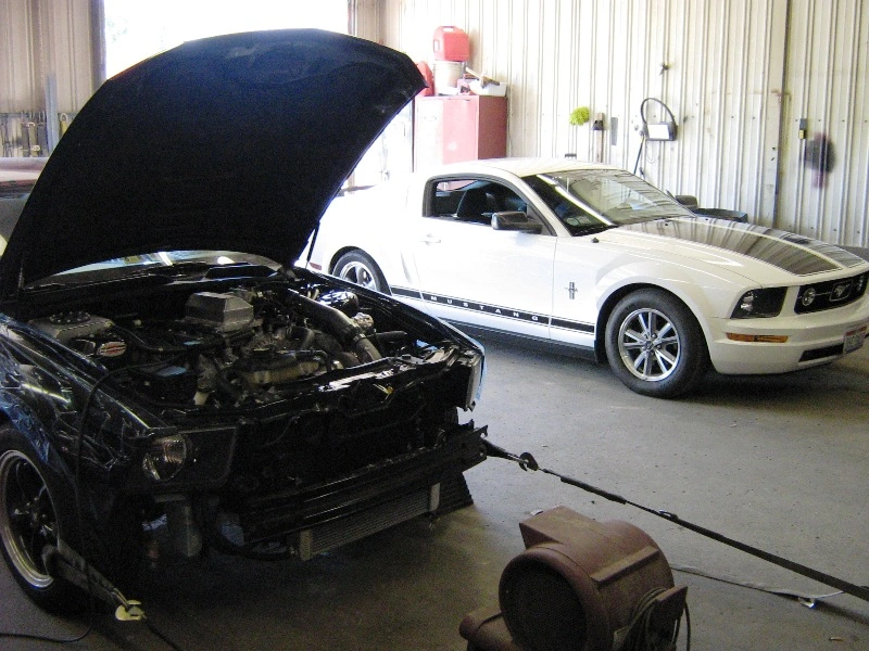

I recently posted up some new pics of the car, and was asked for engine pics. I figured I would post this up, not sure which section to put it in though as its an odd car. I got my car back from Mike @ Powerhouse two weeks ago.

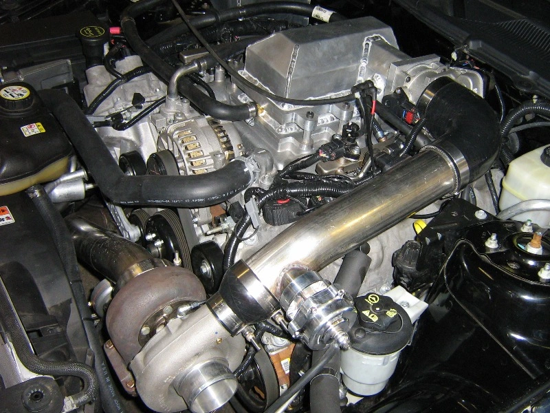

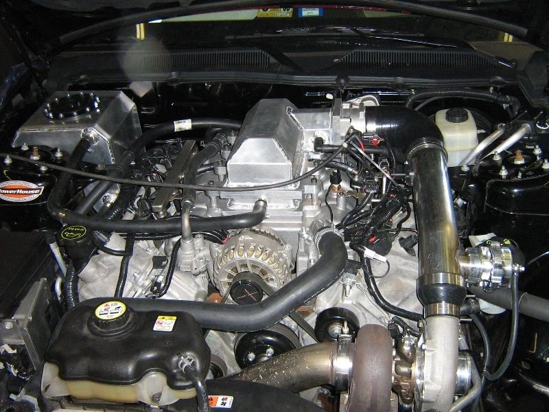

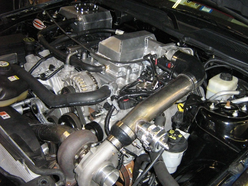

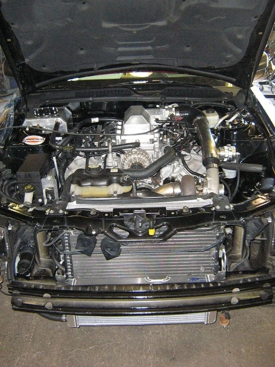

I'm still up in the air on powder coating the custom intake black, or polishing, though I'm leaning towards having it polished.

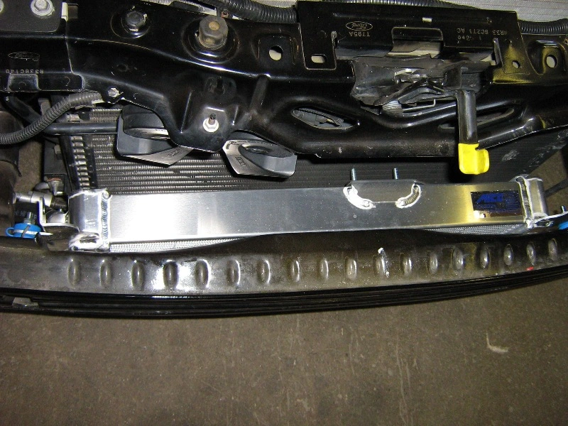

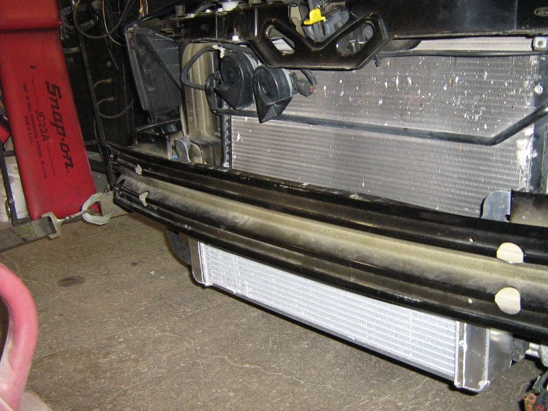

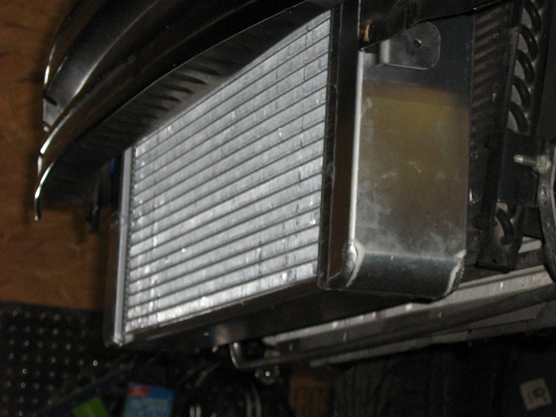

I'm also very pleased that Mike kept the alternator in the stock location. Here are pics of the Afco unit, thought people would find it interesting how f'ing big this thing is:

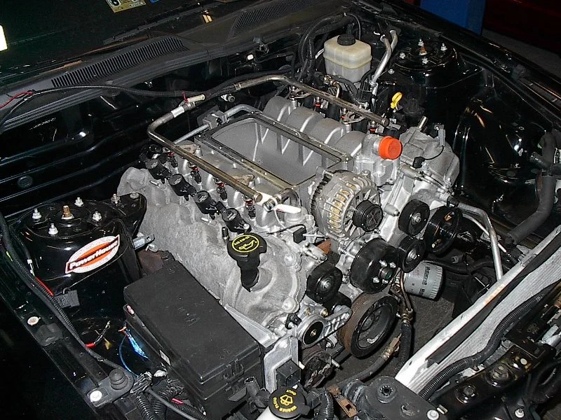

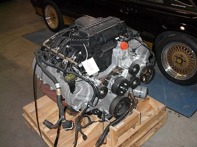

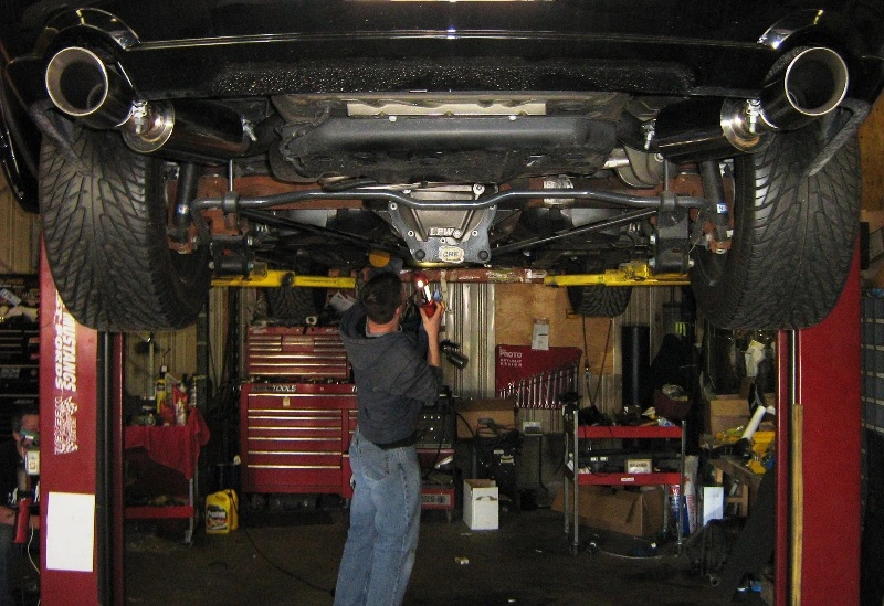

So I got the car back two weeks. A totally different animal than the 4.0. In the fall/winter, I plan to address fuel pump, rods, pistons, drag shocks, may regear the car as well. Here's the high level details:
- 5.4 3V Motor
- PH Turbo for 5.4 3V
- PH Custom intake w/intercooler
- PH Custom water reservoir
- CHE Sway bar delete / radiator support
- CHE Motor mounts
- 60lb injectors (already have a BAP)
- Battery relocation kit
- 4R70, 1000HP capable, Lentech Auto Tbrake Vbody, Billet Midshaft and Drum
- Percision 3200 RPM Stall
- Baumann Trans Controller

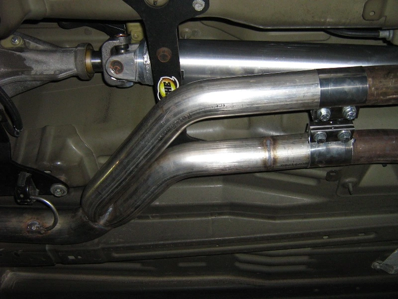

- Custom aluminum drive shaft
- AFCO Heat exchanger
Pictures
