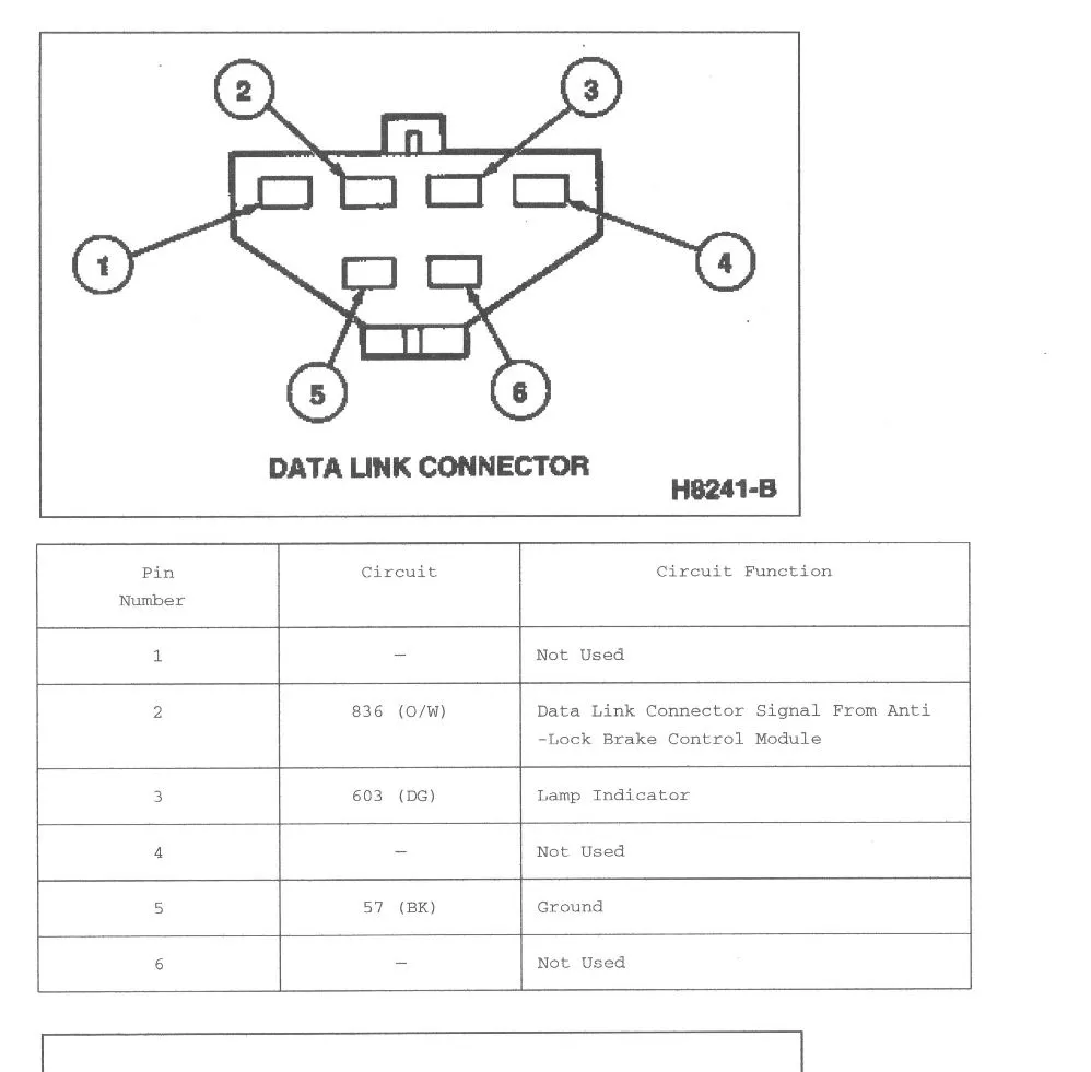

am trying to do this today, and there is no orange and white wire in my connector. i dont even care if it is orange and white, there is no wire in the spot (#2)where the diagram i found on veryuseful.com says there should be for the abs. is this something particular to 95 gts?
Are you using the abs connector plug and not the eec4 diagnostic plug? The abs plug is located next to the fuse box.
junp pin 2 to 5
ok so i did the check.
i got a 19.
apparently that is the anit lock control module.
is it possible that i have a bad sensor and it defaulted to this error message?
i ask because prior to me changing the spider grears, i had no abs light at all and then immediately afterwards the light was coming on and staying on. the only thing that changed was that i had to bang on the sensors a little to get them out.
seems like too much of a coincidence that the 'control module' has a problem all of a sudden.
