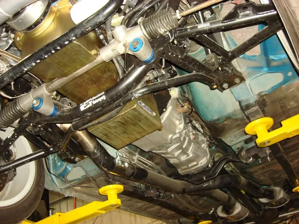

That really makes me feel the need to clean up underneath mine! Most of my components are at least 6 years old so they don't look nearly as pretty. Every time I take stuff apart though I clean it and paint it. Just haven't had to take the rear apart yet.
With the torque arm bar, it took some luck to get the driveshaft out.
