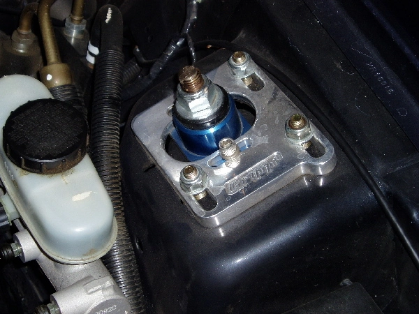

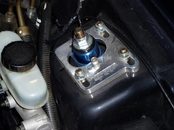

That's not necessarily true. I did "need" them, my camber was pretty far off to the point where you could see the tires turned in. I would've worn the inside of my tire, which "I" would never see if I didn't put them. They're a good idea to get IMO with the ProKit.

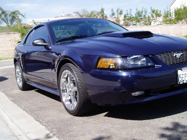

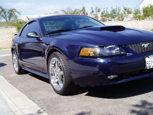

Much better stance with the Pro-kit. Dropped me 1.5" + all corners.

I would recommend c.c plates;friend didnt and wore inside of tire down to cables.

I did need C/C plates

Your stang look's great with
the drop! :nice: Anything is better than the 4X4 stance though.Eibach
makes good quality springs!Does anyone know total how much the Bullitt
and MACH 1 springs lower a 96-98 Coupe? How do they performance?Pics?
