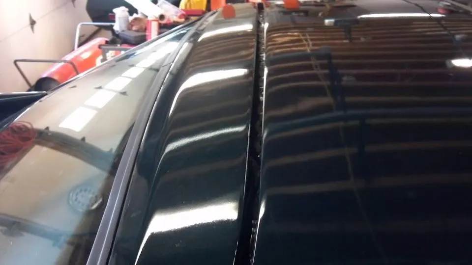

On my stang there is a big gap between the top of the hatch and the roof. I can fit my fingers in the gap. But the rest of the hatch is perfect and the bottom of the hatch lines up perfectly with the tailights. What could fix this?
Looks like your hatch needs adjustment. Loosen the hatch end bolts on the hinge, allow the hatch move a little closer to tighten the gap, then tighten the bolts. You might have to try a few times to get the correct gap.
thats what i was thinking.. but then that would make it not align with the tailights..ill take a pic tomarro to show what im talkin about
