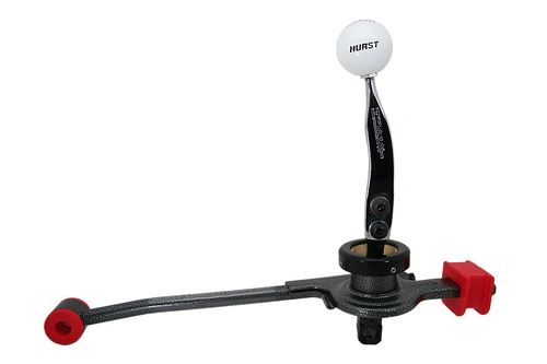

Anything is possible with fabrication. But it's not a bolt-in piece, that's for sure. The Hurst handle attaches completely differently.

and yes, fabrication is needed, as usual in a custom installation.

So it looks like I would have to have one side of the aluminum block milled (to recess the chrome handle) or possibly mount it centered like MGWs handle, could probably make an adapter for that. Thanks for the pic. I will update post if I find a viable method to go that route.

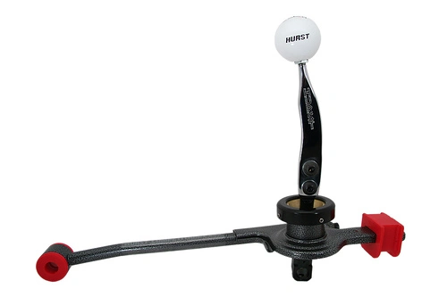

If you really want to change the the MGW and want to keep a retro look, MGW just came out with a new retro ball. It's 2" instead of 1.75" though. I think it's a call to order piece right now. The handle is available frosted or polished and the ball is available in black or white.
MGW shifter with Hurst Ball
You can buy just the hurst ball by itself, and when you order the MGW you have to specify which threads for the shaft, get the SAE ones instead of metric and your Hurst ball should fit on there.
