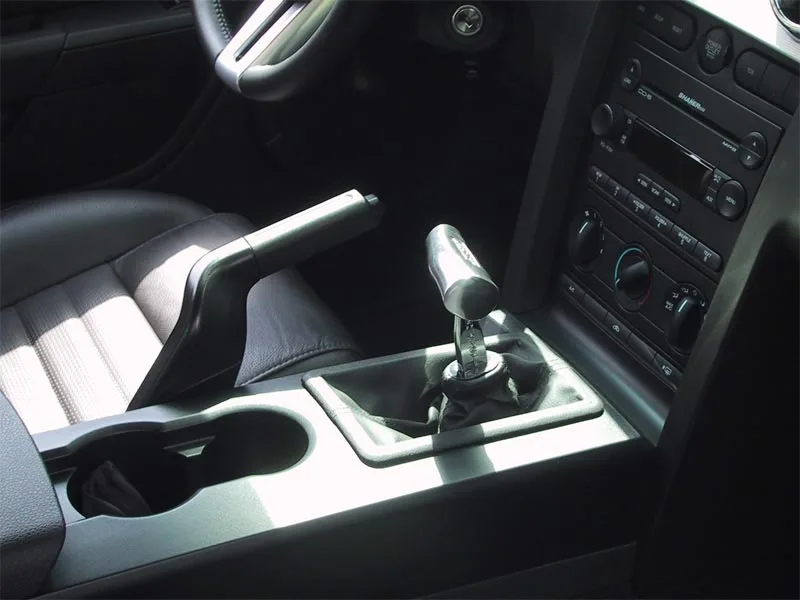

Good luck, and post pics when you're done...
attachment.php

bigcat said:
i was thinkin about the t-handle. do you have another shot of it? from the looks of this pic, i am not sold on the t-handle. i like the white ball the best so far.
That's really the only shot to date, and it was immediately after the install (that's why all the dust). Since then, I've rotated the handle clock wise a bit to more naturally accomodate the palm of my hand. I had a Hurst t-handle in my Roadrunner, and felt nostalgic for it...by the way, my 19 year old son, a mechanic, LOVES the t-handle...
i think the "T" would be more functional as far as grip, but the white ball is more appealing visually
I have both and have gone back to the ball. Having driven a friends 67mustang with the T, I figured this was the way to go, but I did not like the angle my wrist was at with the T.
Here is a pic (if it posts) with the T
is there anyway to adjust the handle for a more comfortable fit? like rotating it clockwise or something? i have never had a t handle before, so i dont know :shrug:
Sure, you can rotate it and that's what I did. Looking down from above, the left side is roughly at 10:00-11:00 o'clock, and the right side points down at 4:00-5:00 o'clock. It took some tweaking a bit so it would fit nice in the palm of my hand. It was dry and 55 yesterday, here in Maryland, and I just had a ball running through the gears. Felt fine for me.
John
