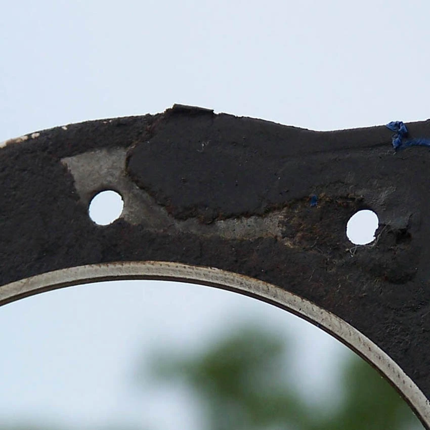

Problem found!
#@&!%@# Ford A302 gasket! I'm going to take this up with FMS. This may have cost me my motor. FYI heads were prepared by top notch local shop and the block was done by M&R Racing. The deck and heads are straight.

It's hard to tell from the photo that the engine was detonating but you can't rule it out either. What was the timing set at?
The engine damage may not be as bad as feared. Surprisingly (and this is a good thing), the aluminium AFR heads didn't warp. Just check the bearings and if they're still OK, it should be safe enough to reassemble the engine with fresh oil and oil filter. Change the oil and filter after about 100 miles to remove any remaining contaminants.
That darker color on the compression ring looks to me like the flame front went over it and shot some pressure in the cooling system which pushed out a hole into the lifter valley.
Which # cylinder and side was it on? Driver's side?

The ARP bolts were down to less than 50 Ft-Lbs. Maybe the 1011-2 gasket needs to be checked more than I did. I put 8548PT2s back in, 80 ft-lbs on the long bolts, 70 on the short bolts.
I used anti-seize on the intake bolts probably lifting the middle of the heads. The intake gaskets were really squished!
I should have immediately checked for oil in the pan as soon as the radiator went low and no water was leaking anywhere.
If the block drain plugs strip, you can drain by putting a ¼” plastic tube in the lower bolt holes. I love this M&R racing short block but they used very soft drain plugs. FYI, I went 15,000 miles on ¾ quart of oil.
The car is back on the road, no problems have showed up, despite doing a pull with water in the oil. I drained 10 qts of mocha!
