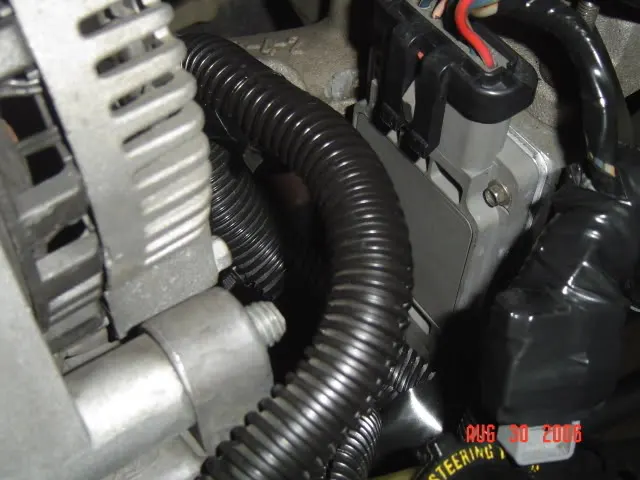

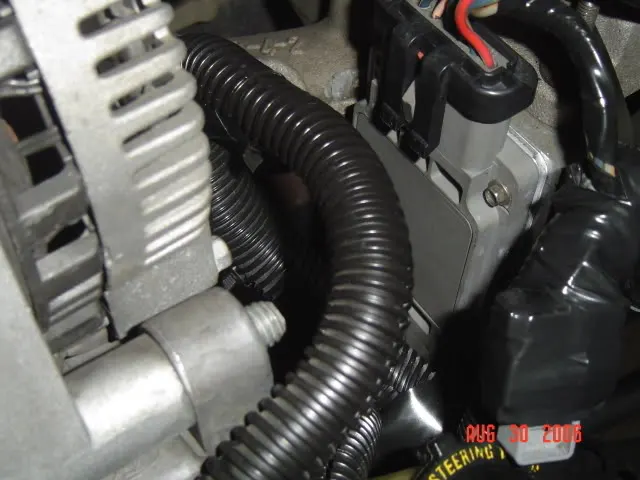

I took a look at my 93 and I did see amodule attached to the intake. You will want to look at the area behind the alternator. You will see the unit. I think this is the part you are talking about. I personally have not really checkout out the dual plug setup in my car mainly because I will be installing a svo engine soon. And that uses a distributor rather than coil packs.
If you want take a picture of the engine bay and we can help out.
This is the Ignition Control Module (ICM). It is a good idea to have the codes checked if the Check Engine Light has come on. It was code 223 and 224.
It is located directly behind the alternator attached to the intake. There are 3 screws that hold it on and two electrical connectors. Disconnect negative side of battery cable. Unscrew the 3 screws and unplug the ICM. Before putting new ICM on, make sure to spread the supplied grease evenly on the metal back of the ICM. If they do not supply the grease, silicone dielectric grease can be used. Bolt it back up and connect electrical connections. Thats it.

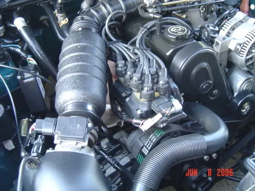

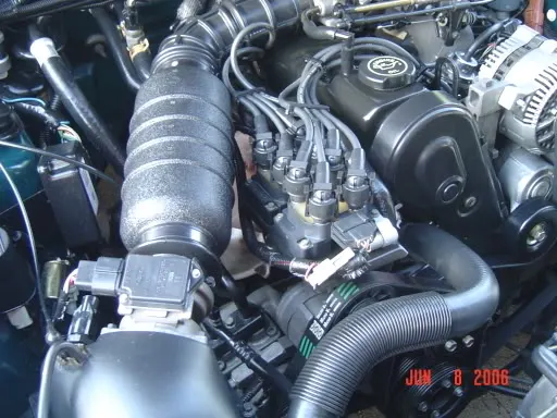

The coil packs can be seen in this picture. The plug wires have one end connected to the plug and the other end to the coil pack. Replacement of coil packs is pretty straightforward, remove plug wires and unbolt the coil packs, bolt on new coil packs and reconnect plug wire. Keep in mind that you want to know which plug wire was plugged into what coil pack and which coil pack connector. I unplugged one of the plug wires from the old pack and then plugged it in to the new one.

Here is a list of engine mods or things done to keep it looking good.
Replaced 2g 75 amp with 3g 95 amp alternator
Removed the snorkel air intake before the air filter
Replaced stock air filter with K&N drop in
Replaced stock hood insulator with oem replacement
Removed prop rod, replaced with Redline Tuning hood struts
Replaced plastic vacuum lines with vacuum hose
Removed decaying stock electrical tape and replaced with cloth tape
Repainted radiator support brackets with high temp paint
Placed a 3/4" wire loom over top of radiator to make a cover
As you can see its pretty much not really modded per say, but my last check of fuel mileage was 21.10, all city driving. The window sticker says 22-29, so if I keep my foot out of it, I can still get the 22 mpg.
I always change my oil at 3 months intervals and always do the 30000 mile tuneups that the book calls for.
Thanks for the compliments, its not that clean at this moment, as I drive it every day. But, it will clean up nicely with just a little work.:flag:
