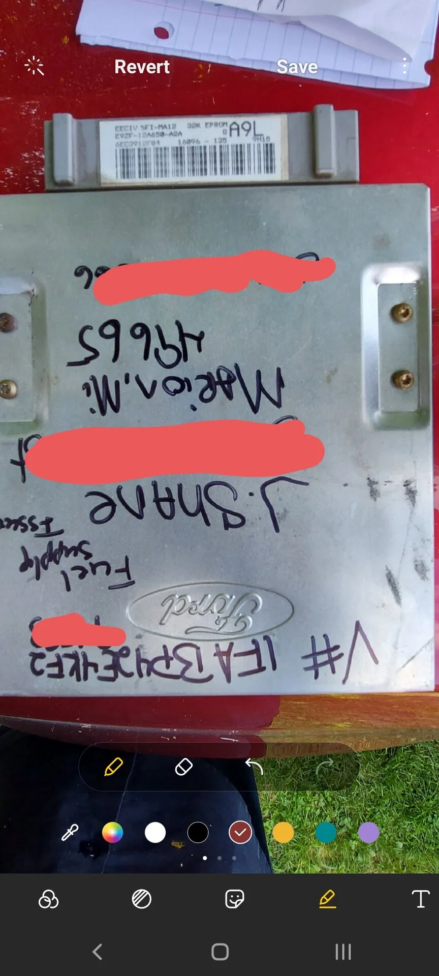

This is it
Casting date code on the block looks like 8J20.
Sept 20, 1988. It’s ab E7TE block which came in all 302s around that time period. Mustangs, trucks, crown vics, etc.
If you have a borescope, pull a plug and see if the pistons have valve reliefs or are flat tops.
I would also verify cam firing order. This can be done a few ways without having to tear the motor apart too much. Typically you can just pop a valve cover off and spin the motor over by hand and watch the valve events. That will tell you if it’s non-HO or HO.
