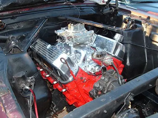

For everybody who gave me advice - THANK YOU!!! - My 302 is now nicely mounted in my 66 'stang - and i will NEVER try this again!

Was this the engine swap that had the problem of the engine tilting? Just curious incase I missed the fix. Looks like a really sharp setup, good work.

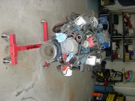

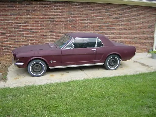

Yes, that was just one of the problems - others include - motor mounts didn't line up, oil pan hit the chassis bar, had the wrong C4, transmission linkage too short, and a few other little bumps in the road. The fix was to break out the saws all, take the chassis bar out, weld in a custom one, strangle the parts counter dude to get me the right motor mounts, get another entire (larger) C4, and to bolt the tranny to the engine while on the cherry picker and maneuver it all into place - The most used tool in the garage - my HAMMER! :D Thank you by the way! May go with a shaker hood or a shelby scoop - air cleaner won't fit under the hood - not a bad problem to have, really.... Just for giggles - here's the 302 before I built it and the mustang the day I found it...
