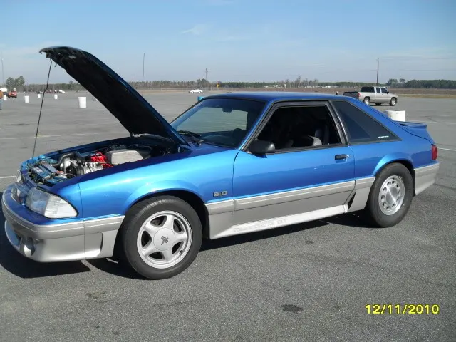

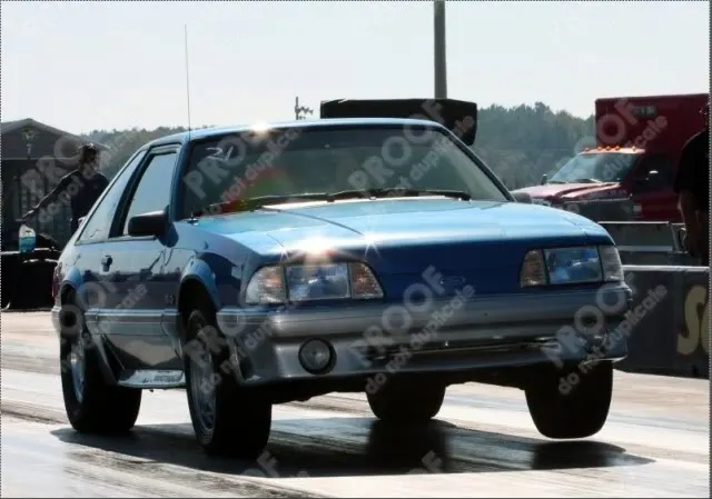

haha. went to the track this weekend and ran on 100% OEM suspension. still had factory struts and shocks from 93. the only change it front sway is gone. put some drag radials on and let her rip.
Im so ashamed of my ET's and 60 ft's im not even gonna post them. lol. my MPH was decent. stayed at a consistant 121 and had a best of 122.4
I also managed to get the drivers side tire about 2-3" off the ground.
Whacha got done to the engine? I've been trying to read up on any information I can find on turbo setups as I've been thinking about going this route. GT is looking good btw.
the engine is a stock bottom end with a set of ported to hell 205 TW heads and a typhoon intake. nothing crazy. im fixing to swap in a 4r70 as my t5 exploded and get me suspension sorted out and hopefully by tax time i can get a dart or similar set up.

I had to go look at my slips. It was a 1.9 60. one of the sucky ones. and first and second held. i went to third and as soon as it cane into boost it ripped the input shaft out of the trans. And i would LOVE to see some low 11's high 10's.

Huh thats odd. but yea i had a few buddies there. and yea some of my buddies are kinda weird about people messing with our cars. we have been sabotaged before believe it or not. and yea my 60 foot times sucked balls. either my clutch would start to slip or i would spin bad. i had like 2 good launches and about 10-15' out when i hit boost the tires would blow off.
did you see me grenade the trans? i wish they would have got a pic of that run. hooked good and pulled out hard then boom. Figures the only clean jump i make it would blow up. oh well
