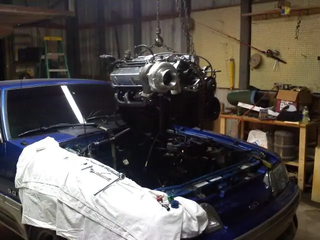

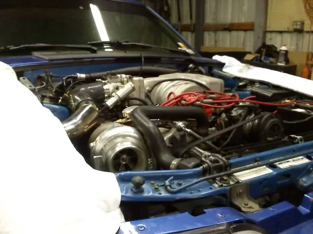

Engine: ported TW heads, stock bottom end, stock cam
Fuel: 42's, 255 pump, stock rails and lines, pro-m meter, moates QH tuned and burnt to an sct chip.
turbo is a knockoff 72mm, BOV and wastegate are also ebay specials.

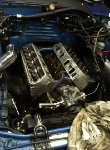

and for NiK this is all i have of the heads man. i REALLY want everyone to see the exhaust ports. there not even square anymore. they look like squashed letter 8's the tops of the ports actually are at the edge of the bolt holes. I tried to cut a stock gasket out for it but it left me with an 1/8" at the top and on the edge of the outermost ports. crazy.
