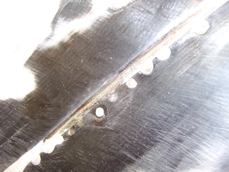

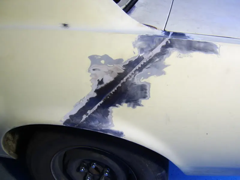

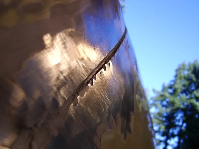

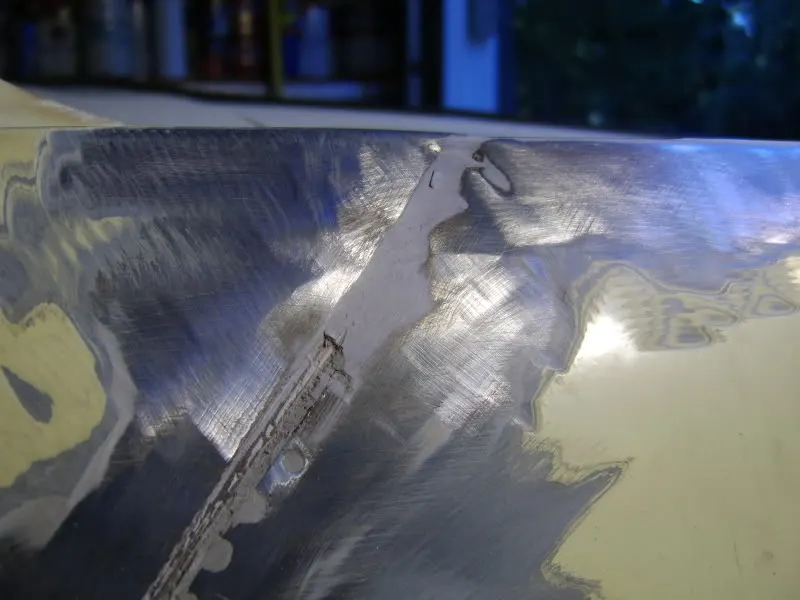

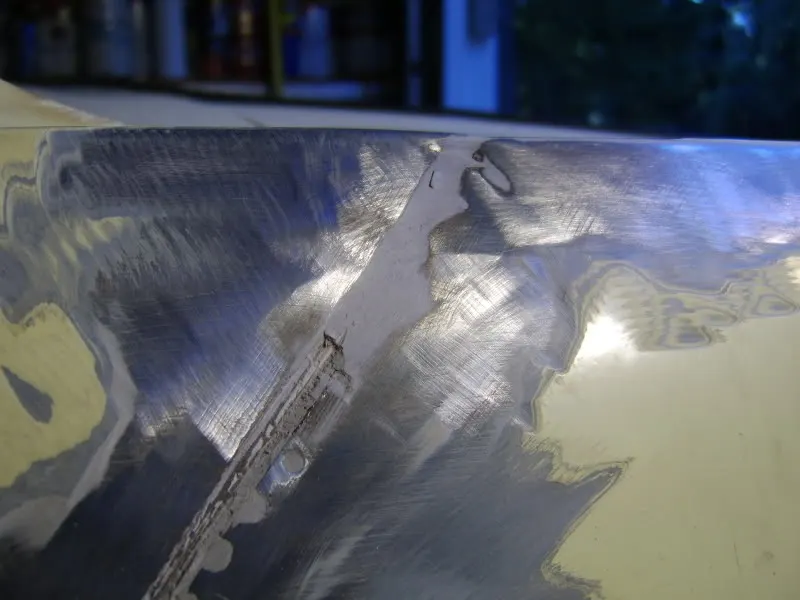

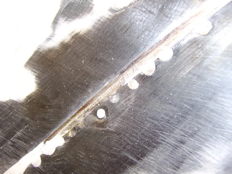

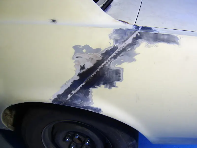

I HATE previous owners and body filler!
Started to take off the old paint in the process of getting ready for paint and this lovely little surprise showed it's ugly little face... :eek: :bang:
What is wrong with some people...
So now the question is do I just lay a bead to fill in the gap and grind smooth and hope I can block it smooth...
OR do I replace the whole quarter panel? What's the "proper" fix for this?
This isn't a common practice in bodywork is it? I'm afraid what else I am going to find... A little frustrated now as I just spent over $6g's on an engine to put in this bucket... Poop. :nonono:

How is that piece attached...spot welded, plug welded, lap weld? I know it's always an unpleasant surprise to find majorbody work on our classics, but judging from your pics I've seen a lot worse (one example is in my driveway).
That's really not that bad, although I don't know why they didn't change the whole quarterpannel. TRUST ME, it's not that bad.
Unless the job is totally botched, I'd fill it up with plastic again.
+1
I've seen worse, all in all thats not too horrible looking. Hopefully you can weld that closed and grind smooth.
x2
Thats pretty normal if you ask me....I would tack it some more just to fill in a bit and make sure the panels are fully welded to eachother. Have you welded body panels before? That is honestly pretty normal. I have yet to see a bodyshop put in the proper metal work like an old hot rod builder would. Make sure you are just tacking it together and going easy on the grinding so you dont warp the panel. If you do, you will be using a lot more filler than they did. The key to doing a patch like that is to weld the pieces together. Weld the lip of the patch panel to the old metal with tacks. You dont want the flex of the car to pull the pieces together. It looks like it was plug welded from the inside with the metal flanged. Just weld the outside to ensure it cant pull off

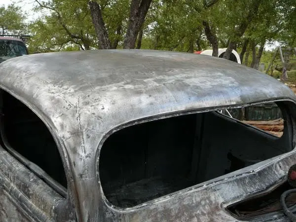

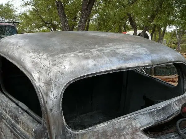

Here is a chop a guy did on a 41 ford... he cut down the crown and chopped the top. I would consider this great work and you can see the welds are not completely filled in and ground smooth.
I would use a plastic filler, lead is NOT safe and is NOT as good as the fillers these days. People stick to lead because they are "old school" and people give bondo a bad name. Bondo under 1/4" thick is perfectly normal, the least amount the better.

Alright, glad to hear there is still hope. I gotta give it to the guy who did the bodywork, it was incredibly straight and I had no clue there was that much filler on the car (first and last time I buy a classic without a good magnet).
The front fender had a good 3/4" by 3" gash that they just body-filled in, no patch panel or anything...
Alright, time to get to work... Thanks for the encouraging words guys :flag:
THis is the first car i have "redone" so I am learning a lot as I go... Welding is going to be one of the things that gets learned before this project is done. I had a welder come out and do some rust patch panels and he let me give a couple a try in places that will be covered by carpet.
I plan on practicing A LOT more before I attempt to fix this little boo boo...
welding body panels is not hard, but you will need a lot of patience. When you weld the, you want to tack weld them together. You tack the panel on just to hold it and slowly tack across the panel. You want to to a tack every 1.5-2" so you dont heat up the metal to much. Then you go in and weld between those tacks, then come back and weld between those.
The idea is not to heat the panel. Sheetmetal is very thin and will warp if it gets heated to much. Never weld a spot within an inch of what you just welded. I hope this makes sense.... I guess its kinda like this:
Pass 1: tack........tack.........tack.........tack
Pass 2: .........tack.........tack.........tack.........tack
When grinding, dont lay into the weld...let the grinder do the work. You want to grind a tack for a few seconds and move to the next...dont try and pull down the whole weld at once, work it a bit and come back to it. Best thing to do is get most of your welds in and grind across the whole panel back and forth to keep the heat off of one spot.
Im sure others will give you some advice as well...if you have questions, just ask
