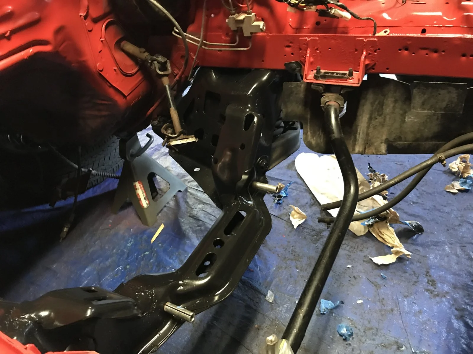

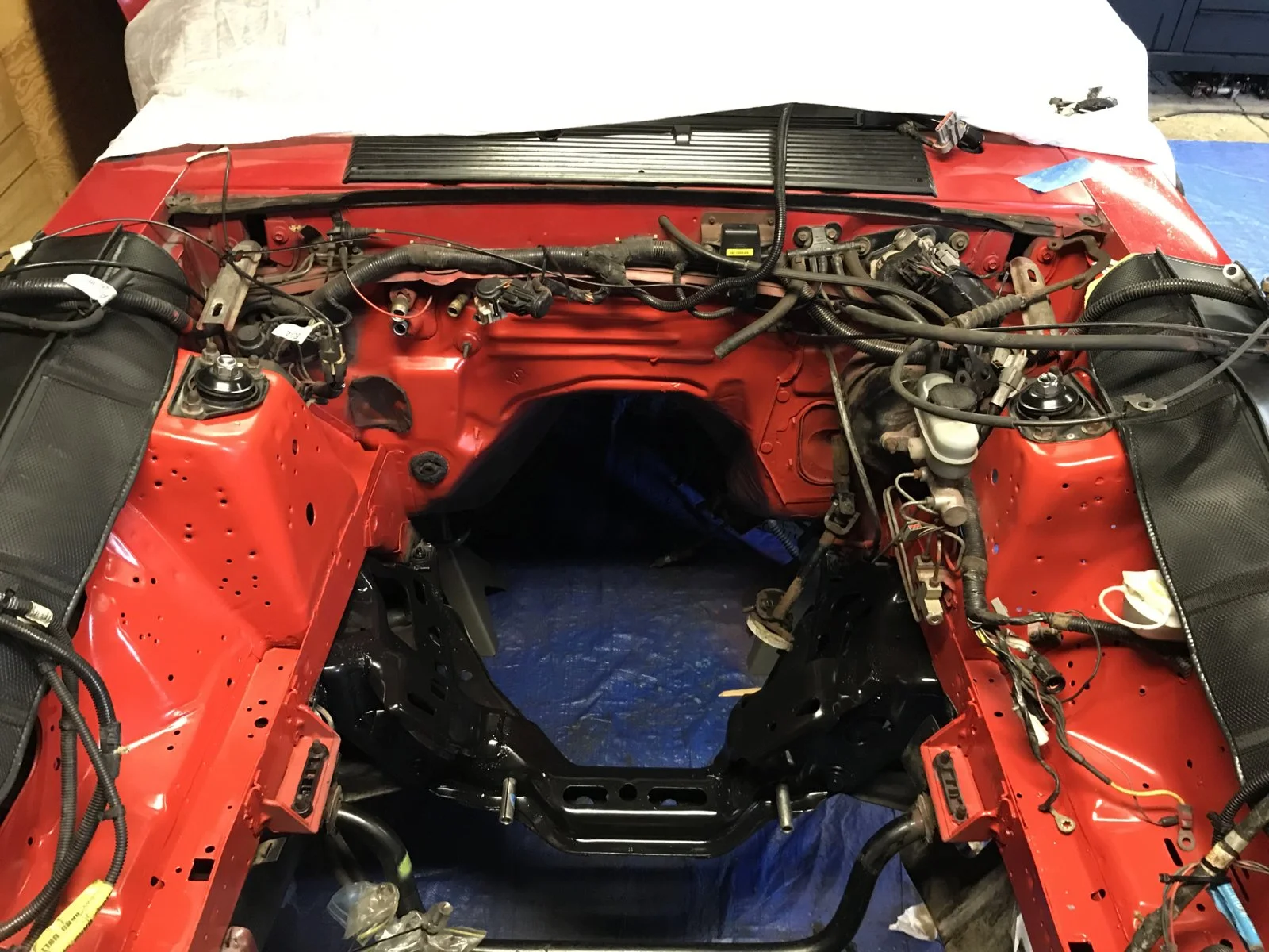

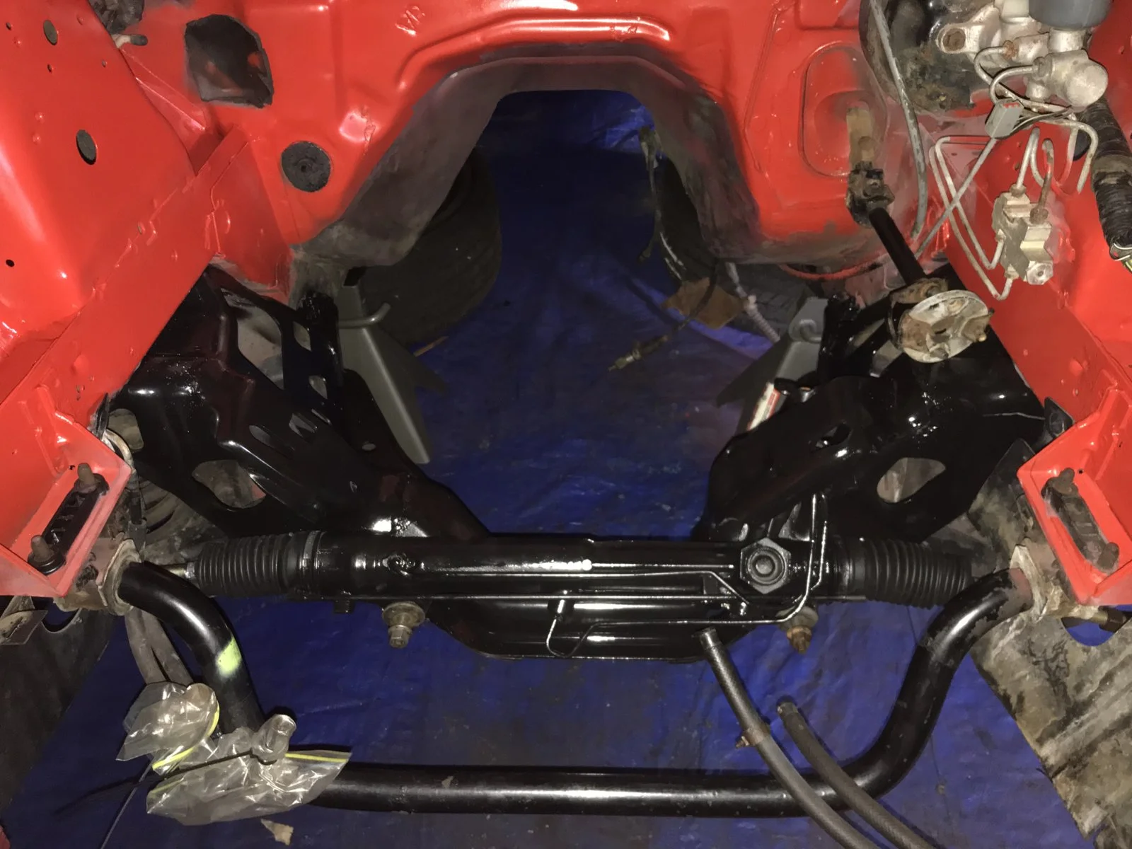

In the mean time, I’ve been busy sanding, priming, and painting the engine bay and K-member as well as changing out ball joints, bushings, and the rack and pinion.

Sounds like you’re covering that, Great job freshening up the engine Bay, Frame, replacing the wear parts, sure you’re not done- either, lol!
