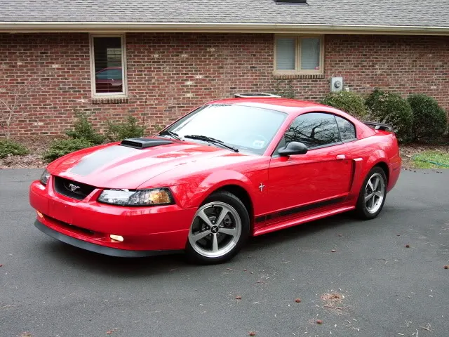

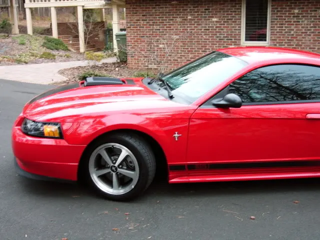

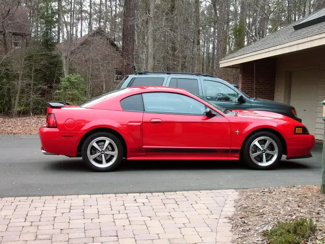

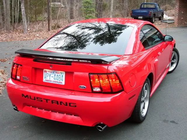

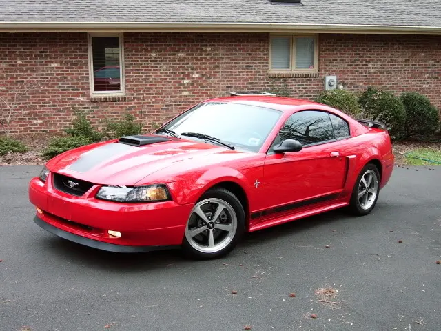

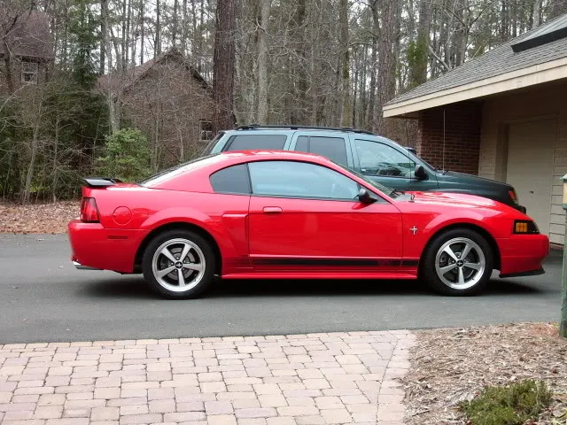

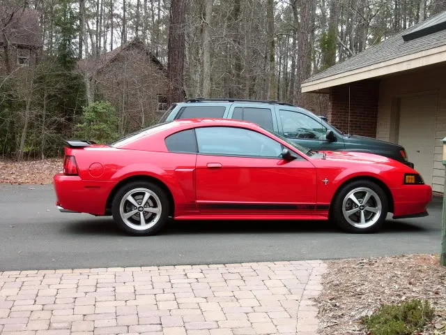

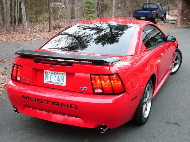

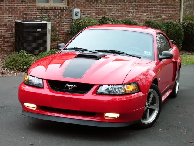

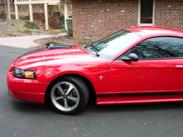

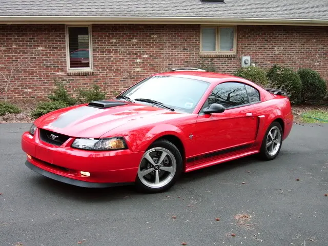

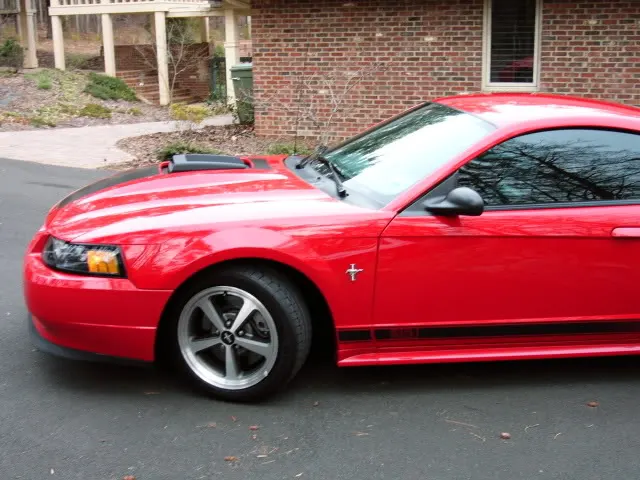

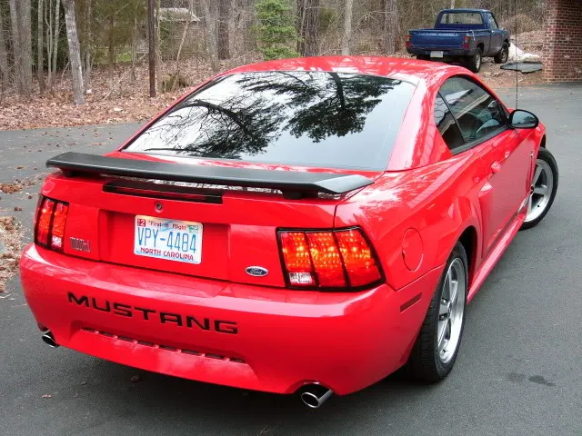

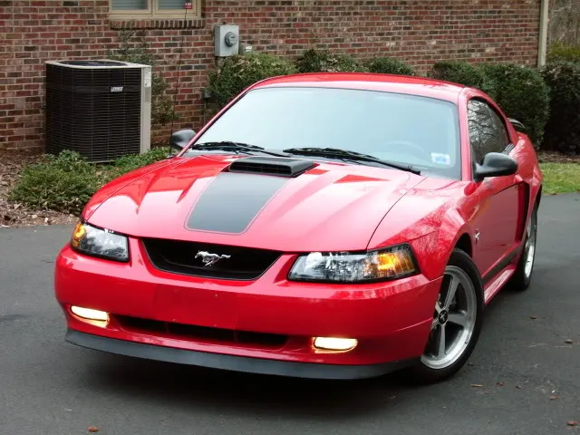

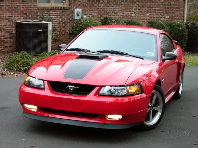

Heres some pics

Thanks guys I think shes purty too. My poor 93 just sits the the parking lot all day waiting for me to buy a house and get a garage. Then I plan to mod the hell out of it
