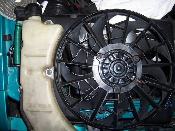

Ok i started going over everything today like checking the antifreeze...Oil level after the trip home...Trans fluid...And i noticed...That i dont have an Overflow bottle for the antifreeze..I know i should instead i have a hose going nowhere to the ground im sure it needs one and had one im thinking the guy took it for his other mustang...What does it look like and were does it go any pictures would be great thats guys...Oh yeah were can i get one?
You can get resto bottles for not too much money, or just use a universal overflow/catch can.
In OEM form, the bottle on an aero fox is on the drivers side of the radiator shroud.
I think i know why its not there i see the trans lines run to that spot in the radiator,were the overflow goes I think...i see new compression fittings there to the trans lines..Anyone have a picture of the stock location and to see where it bolts to...Thanks..
In this picture, you're sitting where the engine is, looking forward.
It is contoured around the driver's side of the fan shroud opening.
Note: The car pictured has an aftermarket electric fan installed.
