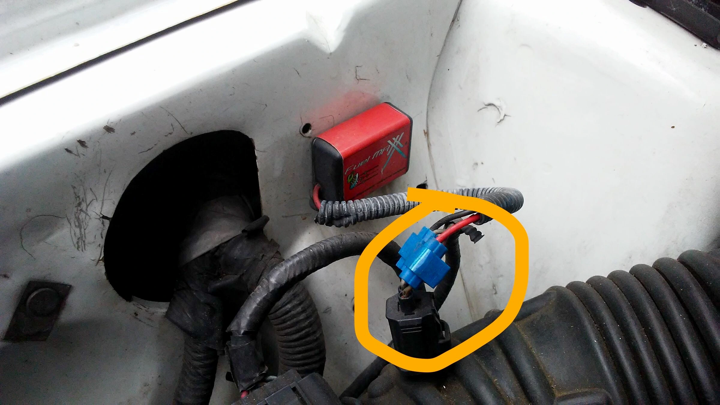

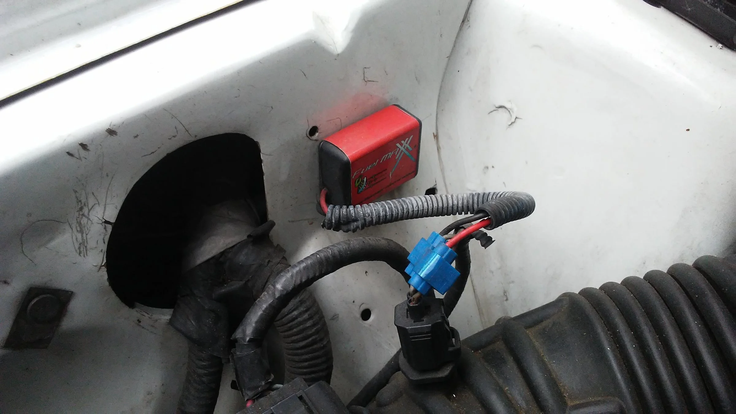

Om so I got a 98 gt about a week ago. It has one of them fuel maxx things wired in to what appears to be the ait sensor on the intake piping.
How do I get rid of it.
Reactions: RaggedGT
Open up the tab on the blue splice connector. Take a pair of needle nose pliers and pull the little metal blade out-remove the wires from that max thing-remove the blue connector and tape up the little cuts in the wiring
