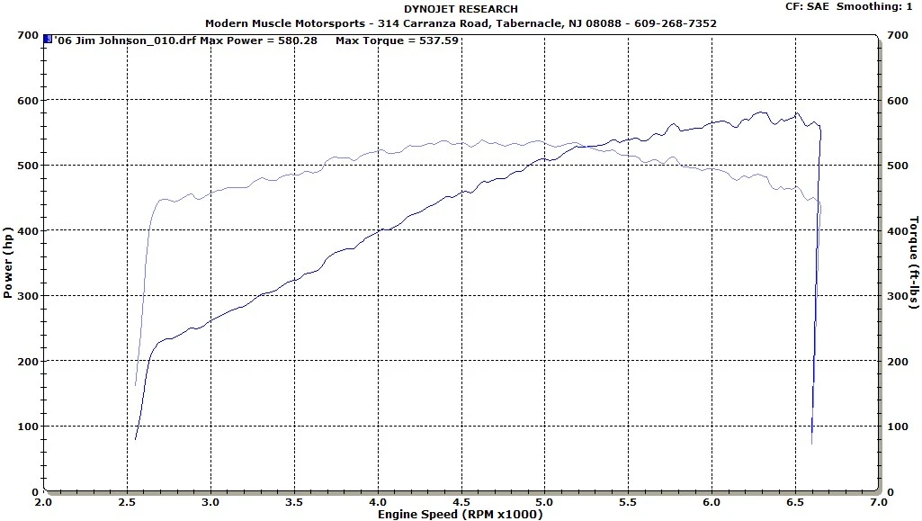

Here are my dyno results
4" pulley 8-9 psi = 456/433
3 1/2" pulley 10-11 psi = 480/450
3" pulley 12-13 psi = 510/490 dynoed on a very hot day (bent rod in a week)
Now with built bottom end SPR 127550 cams, KB throttle body
3" pulley 580/537
