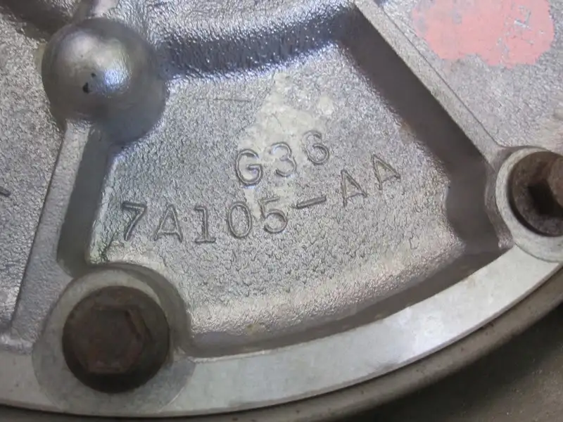

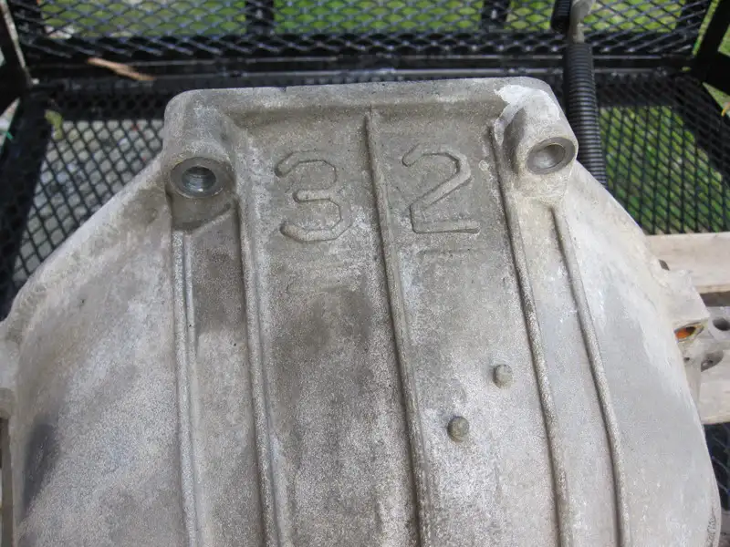

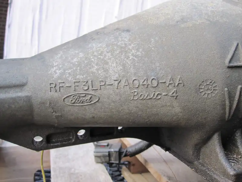

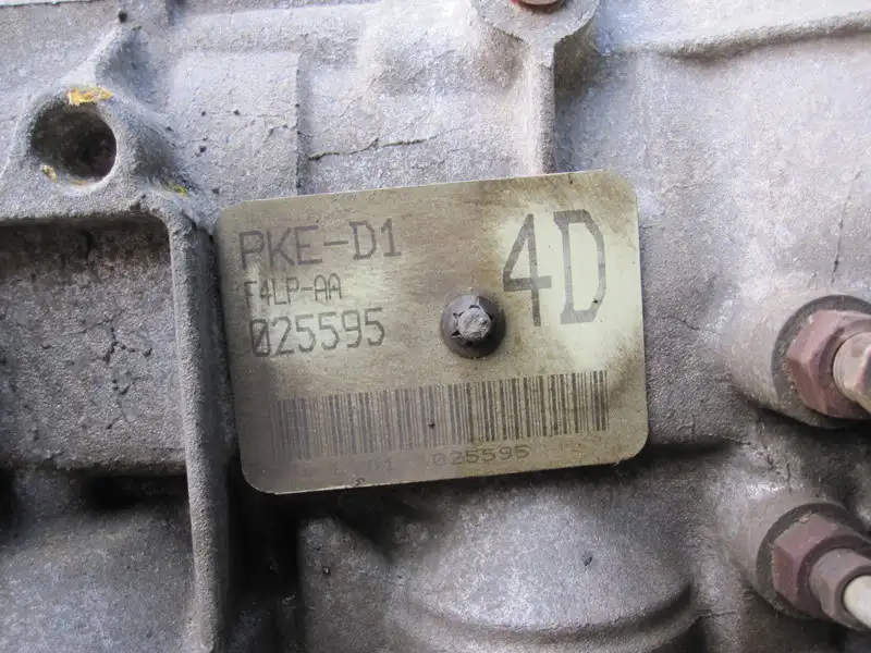

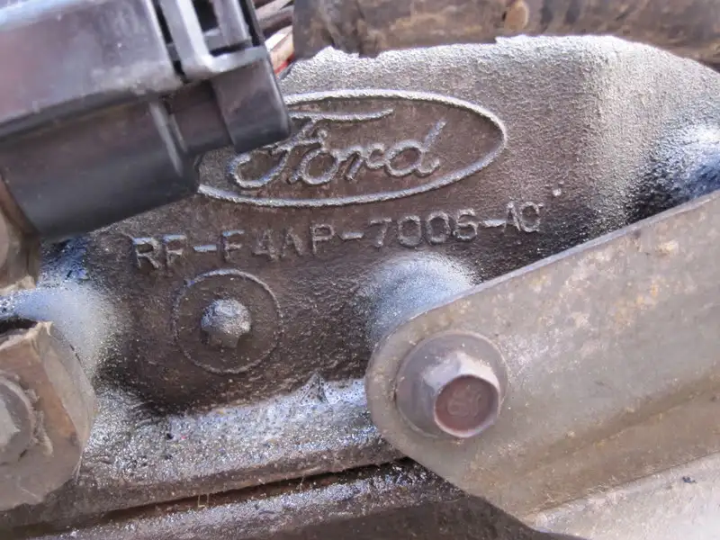

I snapped some pictures of the numbers. From what I've gathered so far, it is indeed a 4R70W. I didn't realize there were so many different 4R70Ws. I haven't compared with the numbers on mine yet simply because I can't get to them with the catalytic converters. Is there a list anywhere of compatible 4R70Ws that will work in a mustang?
On the Tag:
PKE-D1
F4LP-AA
025595
Bellhousing:
32
Body of Transmission:
RF-F4AP-7006-AC
Tailshaft:
RF-F3LP-7A040-AA
Basic-4
Inside bellhousing plate:
G36
7A105-AA
Here are the pictures:
