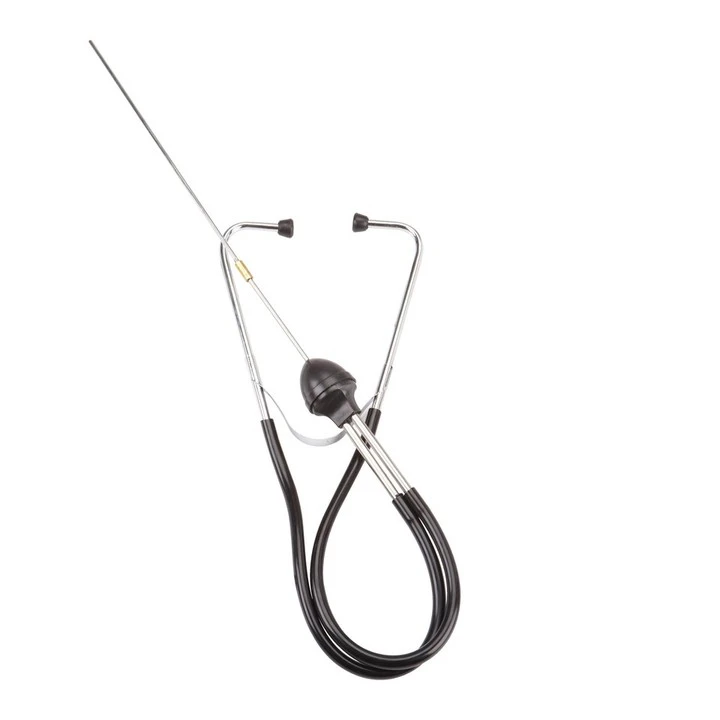

Make a trip down to the auto parts store or Harbor Freight and buy an automotive stethoscope.
Cost ~ $4 at Harbor Freight.
OR
Take a tin can and open it up, leave the bottom in place. Take a long screwdriver and put the blade tip on the valve covers. Put the closed end of the tin can up against the end of the screwdriver. You now have a stethoscope to localize the noise. Try putting the screwdriver blade tip in various locations on the engine to find where the noise is loudest. Loudest noise = location of your problem.
