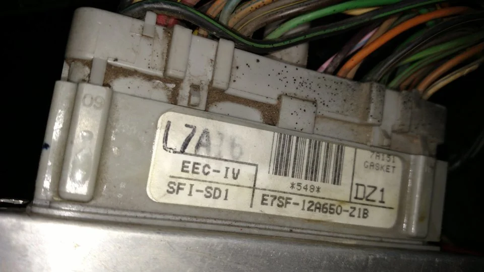

Should I try switching the number 3 & 5, and the number 4 & 7 injector harness? My computer it a DZ1( pic of my computer from when I was fixing it work your help liljoe07).
I assume its a stock mustang computer?

88droptop5.0
Mar 4, 2015
135
18
NEPA
Mar 28, 2015
#40
  • Mar 28, 2015
  • #40
Or should I get the proper cam and put it in, and if so will that correct my firing order?
