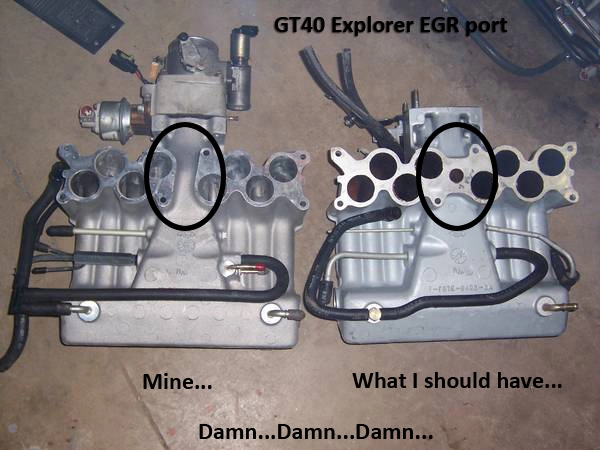

I found this thread. The difference from what I have comparing to the one on his right, is that mine has 3 hoses on the right where his only has one. Also the one he has is going to a fitting near the back, then another hose hooks to the other side of the fitting. Mine only has a one sided fitting. I guess just different years???
I'm just trying to get a visual grasp on how this works, that's all. Thanks for the patience.

Looking at this pic, you probably want to set up your intake like the one on the left, even though your's is on the right. As you can see, most lines are capped.
What some guys do is actually yank out the tubes, drill and tap an NPT plug and cap that hole. It's what I would do. On the intake on the left, you can actually see the guy removed the lower left tube, and tapped the hole to use the Mustang intake "pipe" in it which the vacuum lines all connevt to. Other than this "Pipe", the PVC tubing and a single port in front for the Charcoal Canister, everything else gets capped.
OR, you can run the large line on bottom left to the Vacuum tree, and then out a TEE on the smaller line for the fuel pressure and EGR valve. Then you just need to use one front port for the charcoal canister and cap the rest.
So if you are good with a drill and NPT tap, might be something to consider.

Mine has all the hook ups like the one on the left, but also has the opening in the middle that you have circled on the right.
Either way I have a guy that has done quite a few of these gonna stop by our shop tomorrow and look at the set up. I have never personally done this work. I'm gonna let him do the install as well. To me it's worth it to pay a small amount to have someone do it right. I don't want to try this and screw something up that will cost me more in the long run. I really just wanted to understand this swap more before letting it get done.
