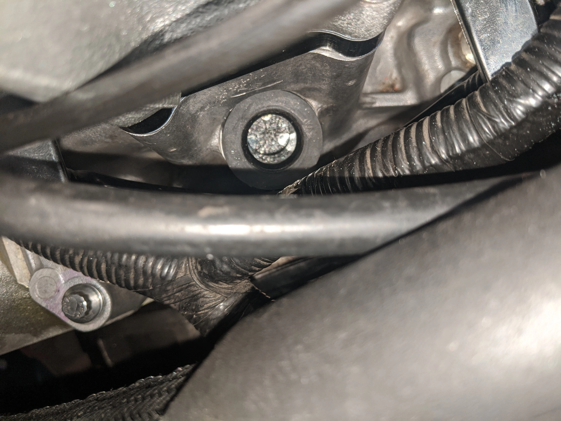

Hi,
Agree with above, pull the PCV Grommet & snap a pic.
PCV is the correct oe part?

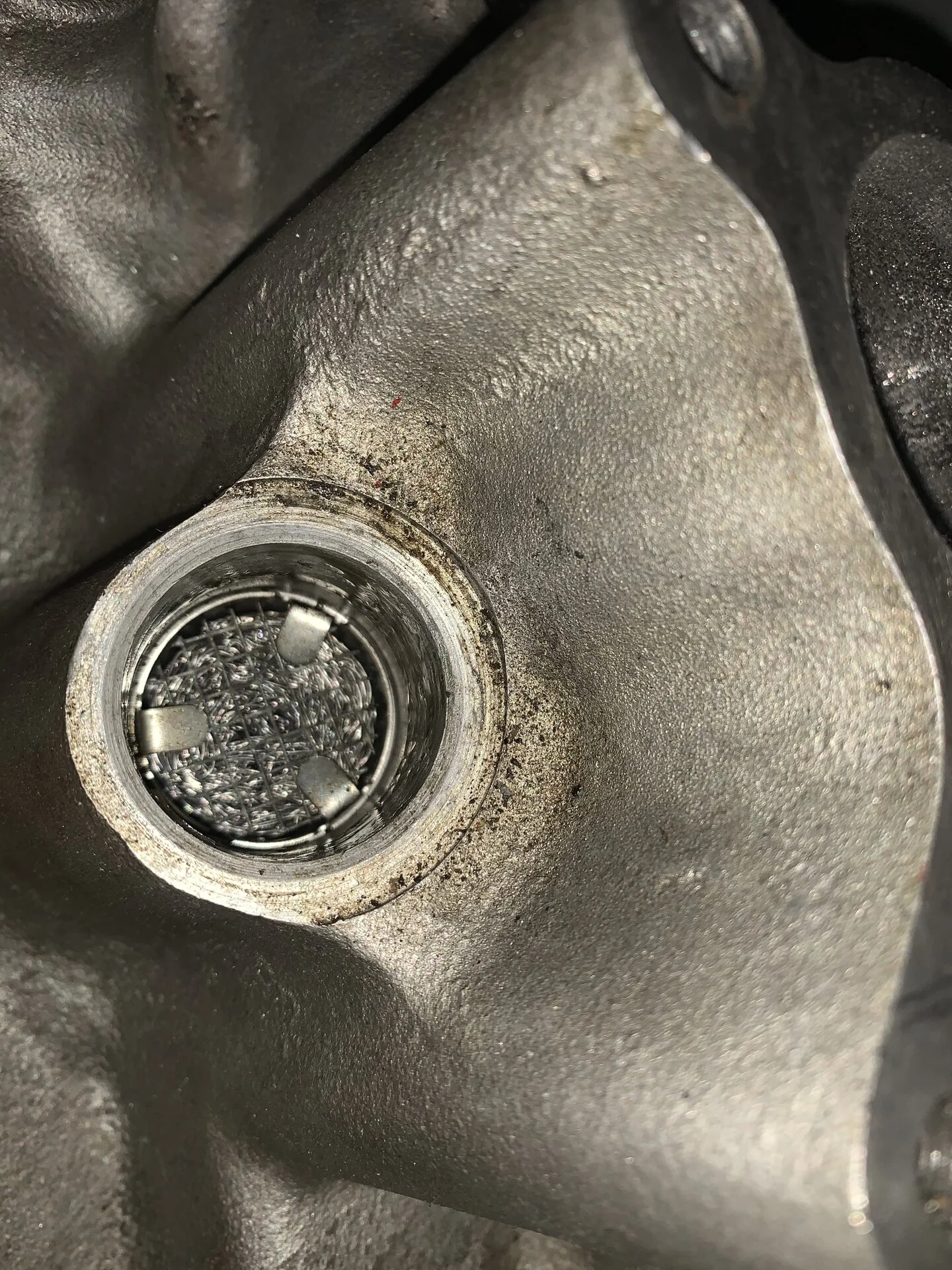

The screen is there. It was brand new when I put the lower intake in. The rubber grommet was brand new, Dorman I think, it didn't fit in there snugly, so I used a little permatex black rtv. The pcv fits in there, but I wouldn't call it snug

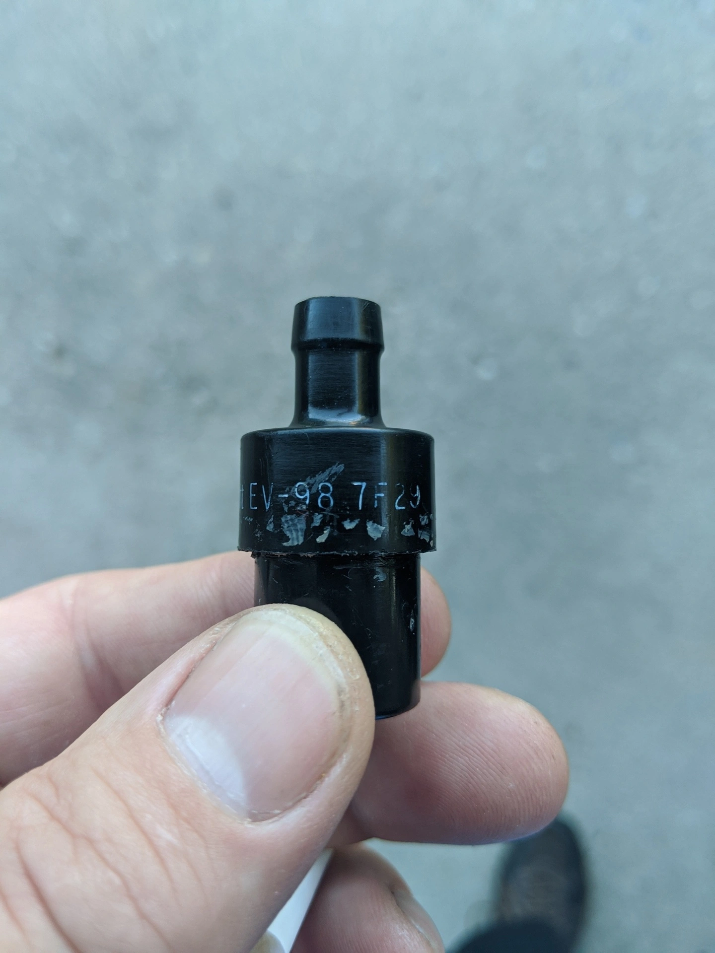

The PCV is a Motorcraft (EV-98). This was brand new in the box in the parts included with the car. I don't think they even make this anymore, the replacement is EV-98B. But I tested the valve and appears to work, not stuck open, air only flow one-way

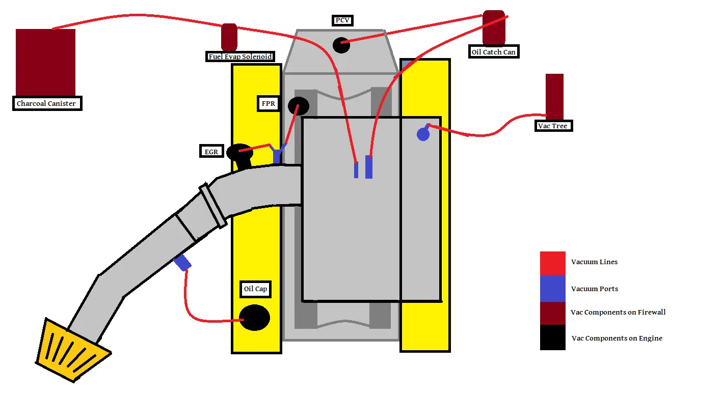

Does the vacuum source matter for some of the components? I've seen a couple different configurations how the PCV, FPR, EGR are connected. Crude drawing, but here is how mine is currently setup
When I got the car, it already had the edelbrock intake on, and that's how the vac lines were routed. (doesn't mean it's correct but it seemed functional).
The catch can came with the car, in a box of parts, unused. I figured it couldn't hurt to install it. It wasn't to remedy anything really
So this spring, when I did a rebuild, I went to a stock intake. I just put the vac lines back the way I found them initially.
I'm getting the overwhelming feeling it's not setup correct? The stock intake I bought, didn't have that little vac tree that threads underneath the intake. I thought that was for 79-93 cars because of how the egr was setup differently than 94-95.

I would compare your routing and make it mimic stock locations as much as possible, the factory does things for a reason, like fpr by itself, don't know the reason though.
In reality, if it works why fix it? Except this thread started with an oil in the intake problem, the routing as it stands may be the problem? :shrug:

If it is showing evidence in the catch can check the screen below the pcv to see if it is soaked in oil. You may have to pull the lower intake to check the baffle. I don't know of any difference between the 86-95 lower cept maybe that baffle.
