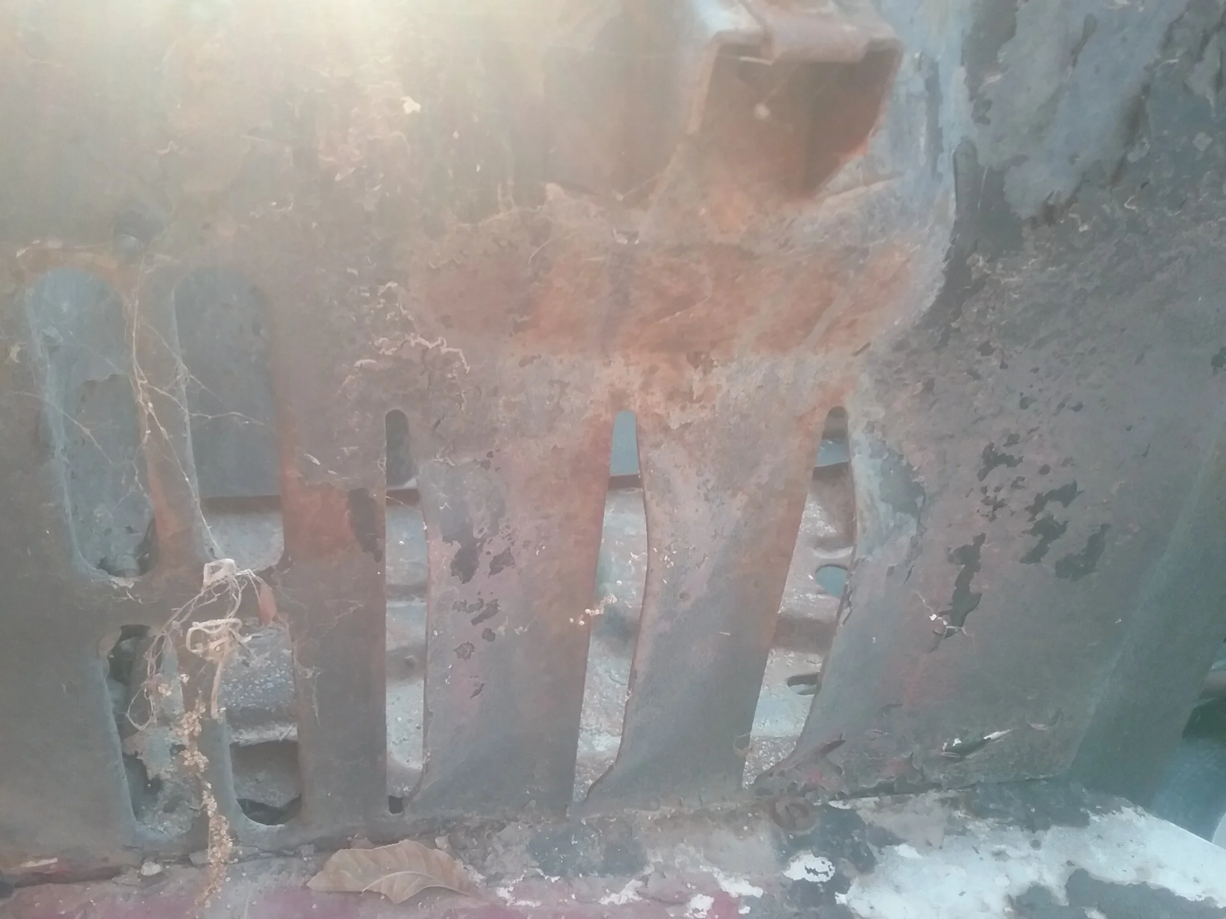

  • Sep 22, 2017
Look at the front of the radiator support ,you will see 3 louvers in front of the battery ,only the 64 1/2 had this

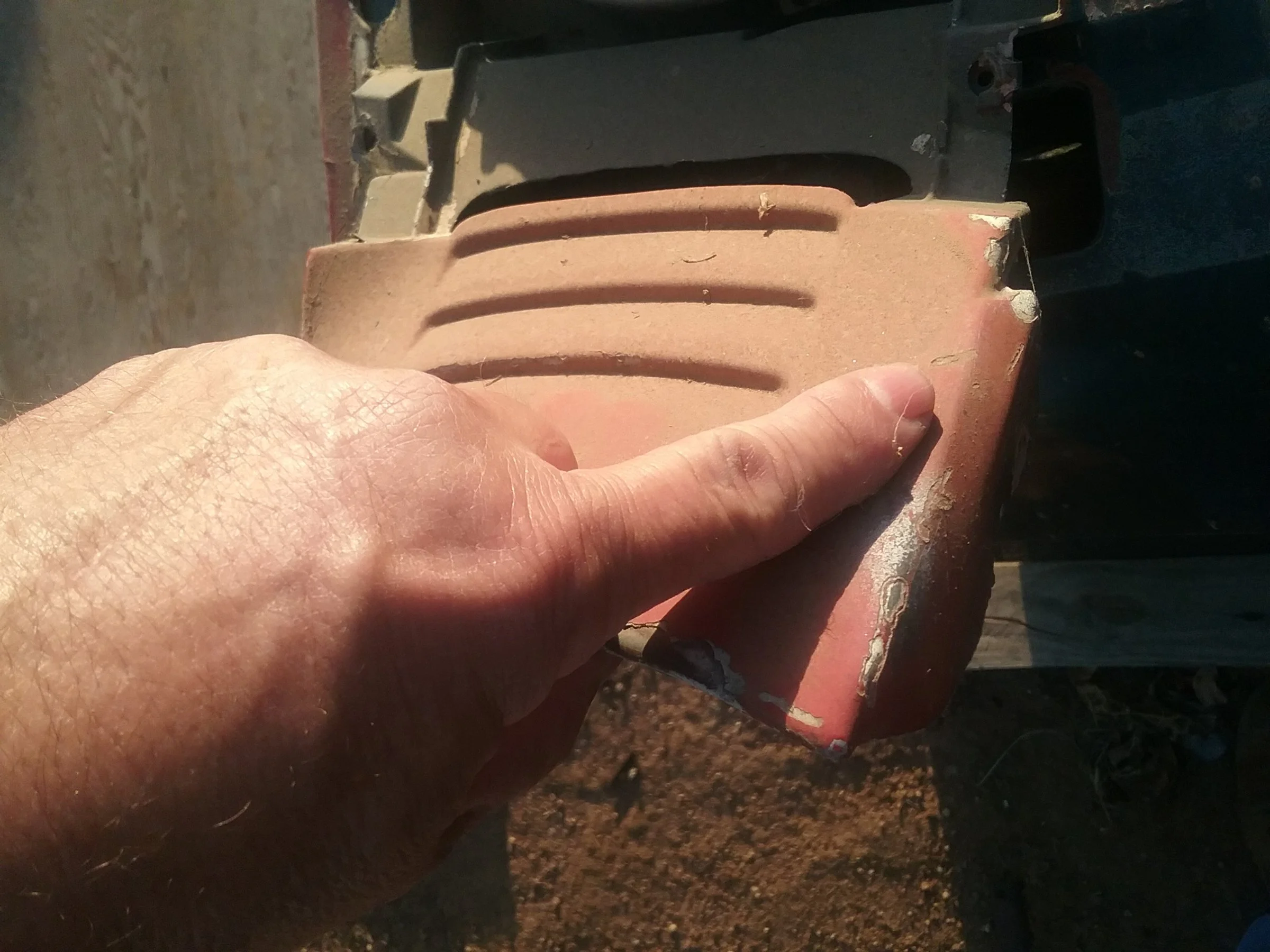

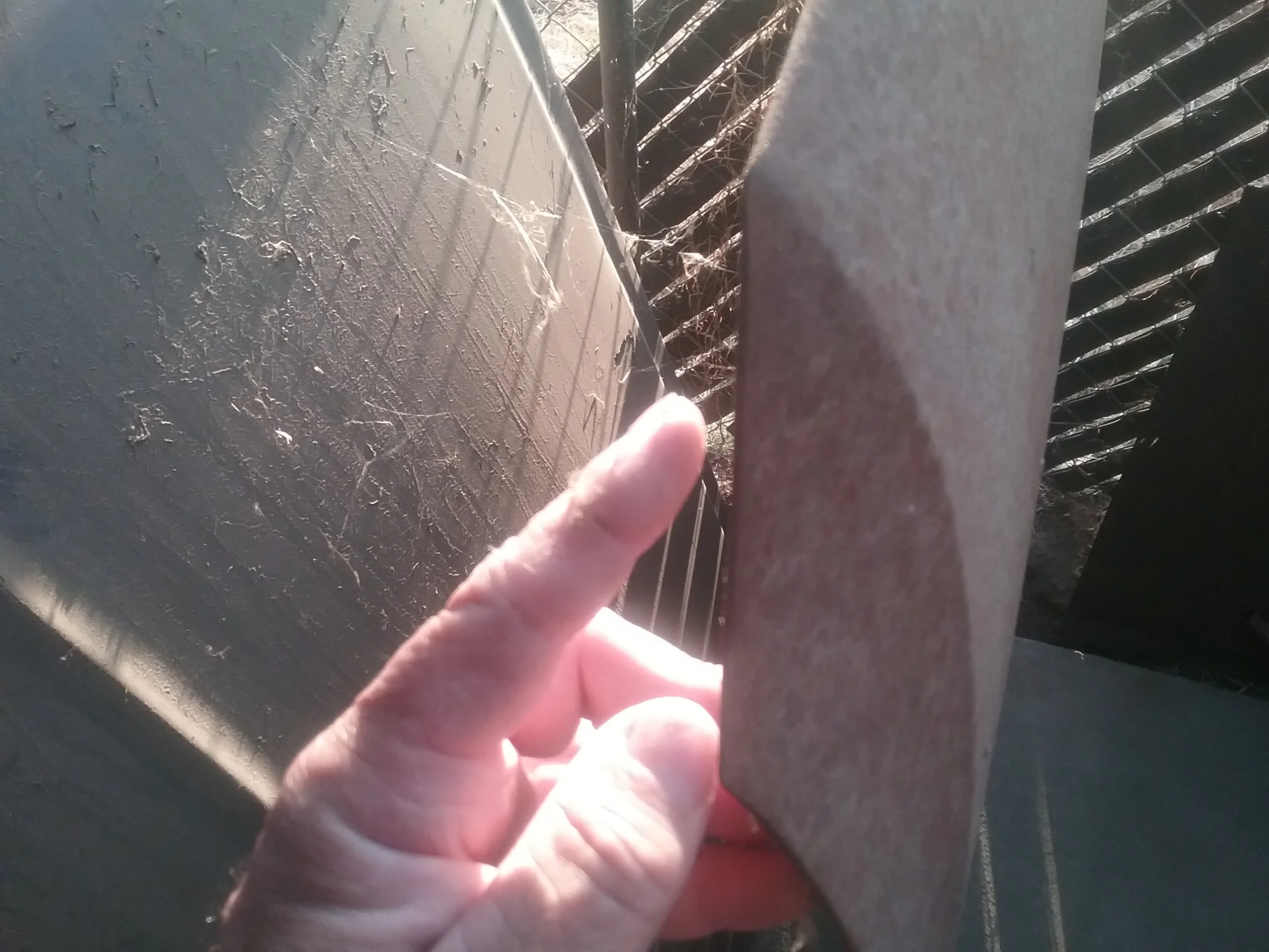

  • Sep 22, 2017
The front of the radiator support ,you can see the 3 louvers
The passenger side seat track is not adjustable on a 64 1/2.
The headlight assembly has a tapered edge where the hood meets up ,the hood edge is not rolled where it meets the headlight assembly ,the 66 as the one pictured here has the edge roled under all the way across the front of the hood ,the 64 1/2 is not rolled on both corners only

Thanks.
Yup, I have those louvers. I also went back to the decoder at CJ's and, which is broken down by year, and 64 is the only year U is an option. That solves that mystery.
