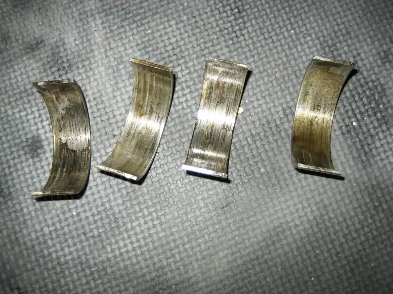

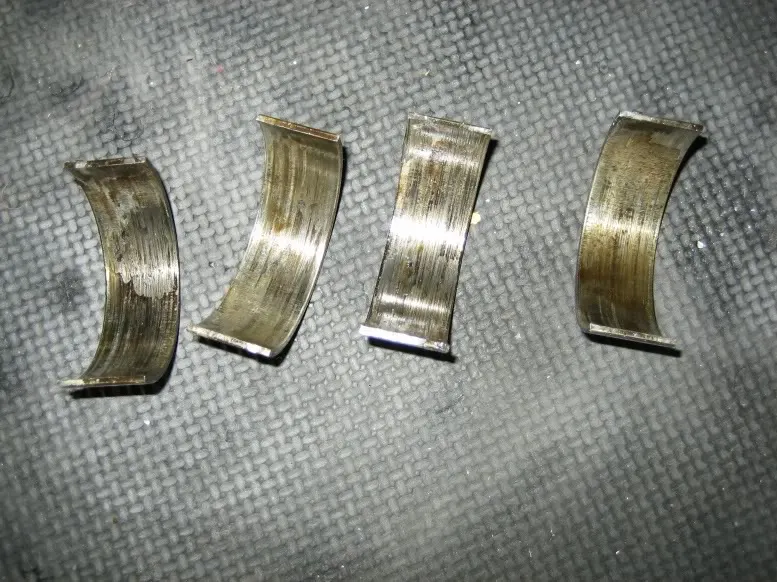

What do you mean by overlaps? During a momentary lack of oil, all it does is grab onto the crankshaft and spin within the rod/main bearing housing. The grabbing onto the crankshaft messes up the crankshaft and sheers off the metal from the inside of the bearing. The spinning sheers off metal from the outside of the bearing and the rod/main bearing housing creating extra room for things to move around and knock.
Here's my example...
About the only other thing that could make a tapping sound would be if somehow your timing chain jumped a tooth and now your valves are hitting but that's not very likely. They sound similar to where I thought it was another bearing and pulled the engine again. I just had that happen but most likely it's your bearing.
